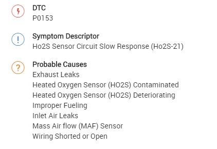

I have two ECM codes present on scan tool p0153 o2 sensor bank 2 sensor 1 and lean code bank 2 p0174 . p0153 on scan tool shows confirmed. Scan tool shows unconfirmed for p0174 after changing DPFE sensor and mil light turned off.have checked for vacuum leaks and exhaust leaks with no leaks present. I'm not convinced the o2 sensor is the cause as fuel trims and voltage specs look normal within range.but at idle in park the vehicle acts like its enriching raising idle and the almost turning off the motor but then recovers to a normal idle. Fuel pressure look good but I'm not sure it the fuel rail damper is operation correctly. What would you advise for further diagnosis and trouble shooting to resolve the lean issue and idle problem. Outside these issues the vehicle runs descent. Thanks in advance for your expertise and help with this matter.

The 153 is for lean exhaust on bank 2. Once you get the 174 code repaired, the 153 should go away on its own.

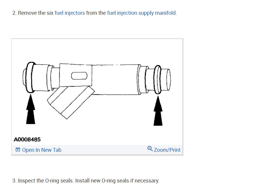

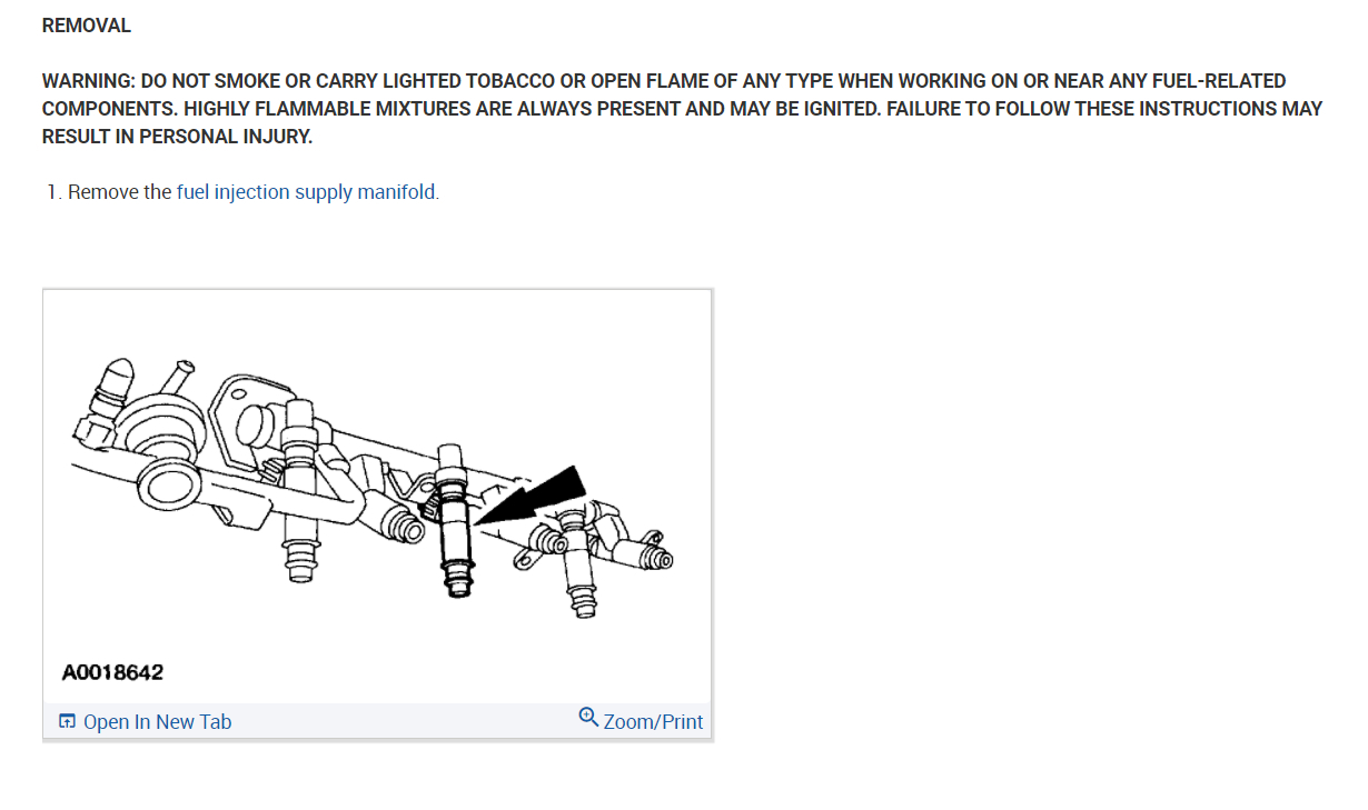

Roy: I thought I had this fixed many months ago but the lean demon is back. { LTFT bank 1 = 2.3 } ( LTFT bank 2 = 23.4 ) I'm leaning towards the fuel injector as the enemy lean condition. The last full scan tool freeze frame details are as follows : {calculated load at 48.6%} { coolant temp 201} {STFT bank 1 minus -3.9}
{LTFT bank 1 2.3 }
{STFT bank 2 26.6} { LTFT bank 2 23.4 }
{Engine speed 1973 RPM}
{ vehicle speed 62 MPH}. Vehicle has been smoke tested for vacuum leaks at motor ,exhaust and evap with no leaks detected or bad deteriorated vacuum hoses found. First threw the p0153 and then a few days later the p0174 was present on scan tool Both codes are confirmed by scan tool . Removed front 3 spark plugs i noticed cylinder 4 piston head was dry and #2 and #6 were showing fuel. So I'm speculating that fuel injector #4 is dirty , intermittent or on its way out. It has a terrible intermittent erratic idle that sometimes almost shuts off the motor and then recovers fast to a normal idle. I'm leaning toward the injector or injectors as I have covered all other diagnostic tree paths. Fuel pump is new and MAF, IAC sensors are good.
