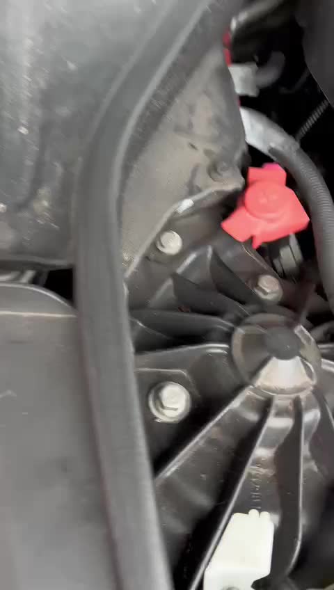

Also, in this video can you hear any timing chain noise?
Thanks for your advice and time!
Mar 11, 2023 at 3:36 AM
  • 54,832 POSTS
Thanks for the video. I can hear the timing chain guide that is broken I believe. Glad you could get it fixed, thanks for letting us know. Please use 2CarPros anytime we are here to help.

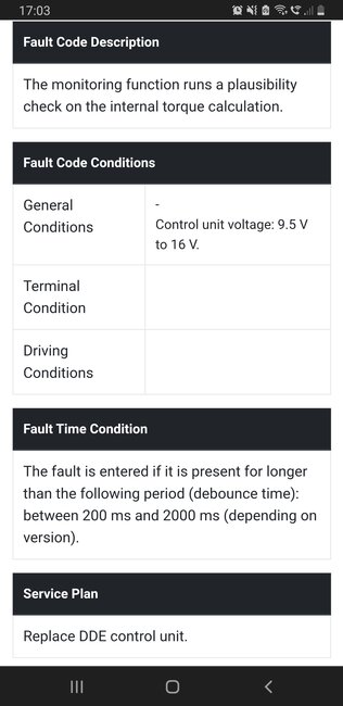

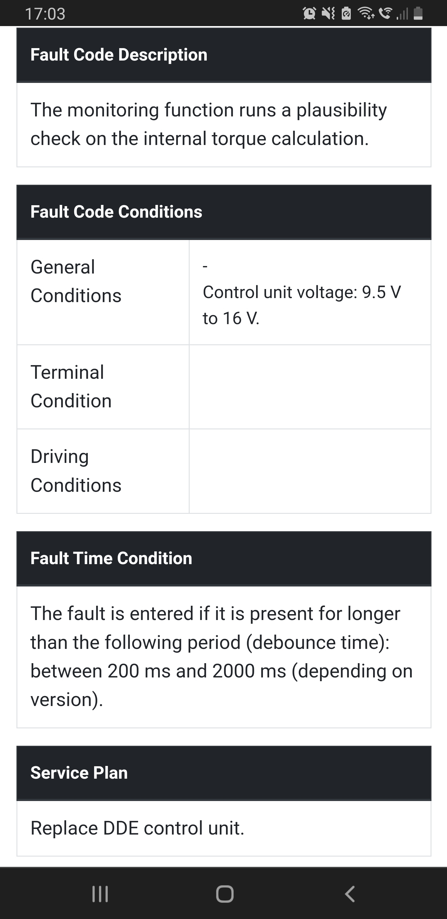

I am getting this code again 2A8B00.
Except this time its advising to replace DDE?
Really confused as this code came up before for the DPF?
