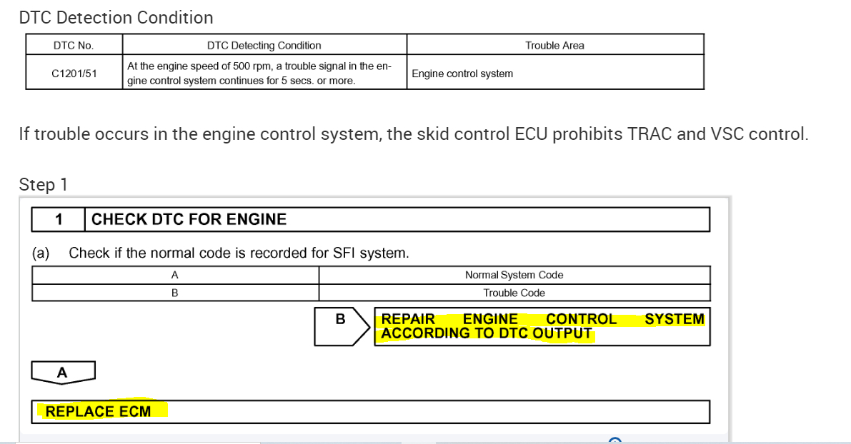

If there is an issue within the engine control system, the computer turns off the vehicle stability control (VSC).
Since you have a P0303, that tells me there was a misfire on cylinder three of the vehicle. Did you notice a misfire at any point? When was the last time spark plugs were replaced?
If you clear the two codes with your scanner, do they come right back? Try this if you haven't. I suggest it because the options are very limited. Take a look at the pic below.
I have a feeling because of the misfire (P0303) the C1201 was set. If the vehicle is running properly, clear the codes and see if they return. If the spark plugs haven't been replaced for a long time, you may want to consider a tune-up.
Let me know your thoughts and what I can do to help.
See pic below.

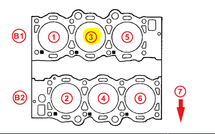

I would be happy to tell you where it is, but you won't be happy. It is the center cylinder closest to the firewall. Did the P0303 return as well? If it did and you plan to replace the spark plug, I strongly recommend replacing the coil pack at the same time, so you don't have to do it twice. The OEM part number for the coil is 9091902246. You can get an aftermarket one for less money, but I don't recommend getting an inexpensive one online. I have seen so many issues with online parts lately.
See pic below. Note, the arrow in the picture points to the front of the vehicle.
See pic below.
