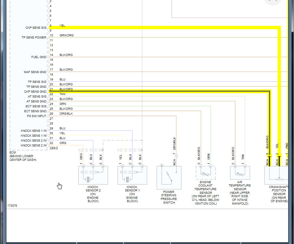

Crank sensor wires had cracked insulation and shorted changed that and now getting codes p0335, p1505, p1507 and p0445. did I fry the ECM?
Jul 12, 2020 at 9:11 AM
P0335 - Crankshaft position sensor circuit malfunction
P0445 - EVAP Emission Control System Purge Valve Circuit Shorted
P1505 - Idle Charge Actuator Signal Low
P1507 - Idle Charge Actuator Signal Low

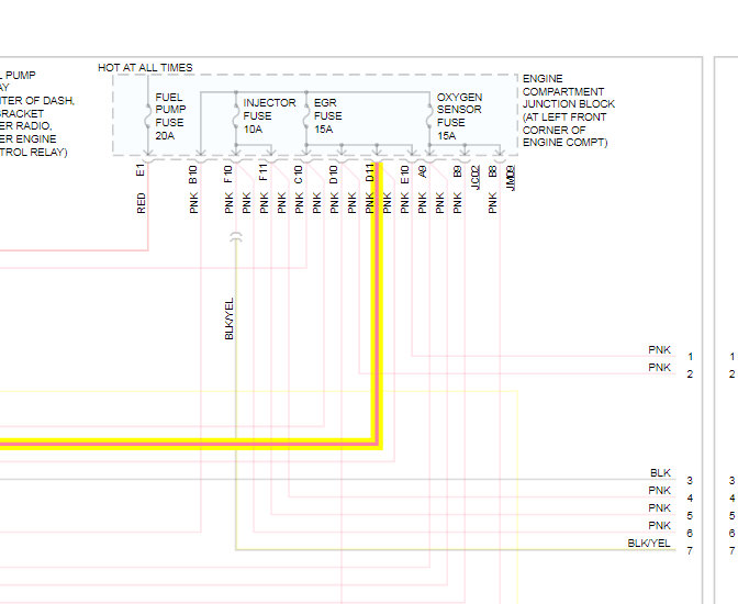

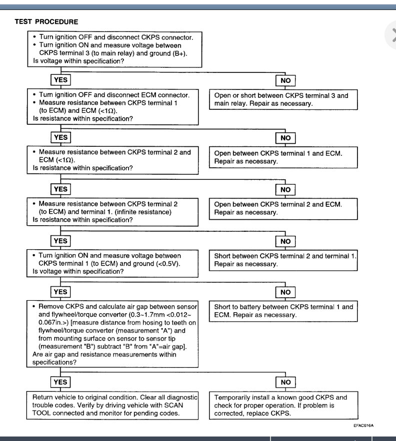

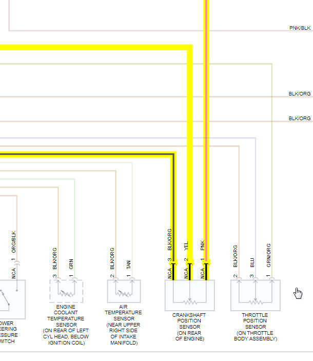

Based on what you are seeing these codes could be related. However, I would suggest you chase down the P0335 due to what you saw. I attached the wiring diagrams and testing for this code. Run through this and let me know what you find. Thanks
