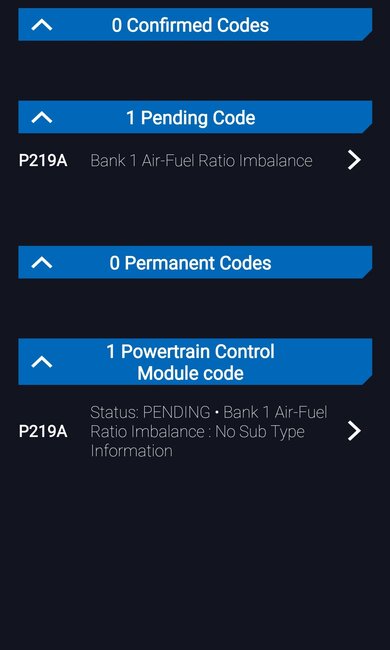

I've asked a question about my issue before and have new information I believe may be helpful. My issue was that my car was idling rough, but only after shifting it to park or neutral. The RPMs bounce from 500 to 1,000, and it's only after driving then going to neutral or park, it idles fine at a stop light. I've been getting a pending error code P219A and have ran checks on it using a reader I got off of Amazon. I have tuned the car 4 times with different companies and on a dyno with no resolution. I've cleaned the throttle body, cleaned the MAF, changed the spark plugs, just replaced all O2 sensors, put seafoam in the tank and still nothing. The modifications are a cold air intake, long tube headers, and high flow catalytic converter X pipe.

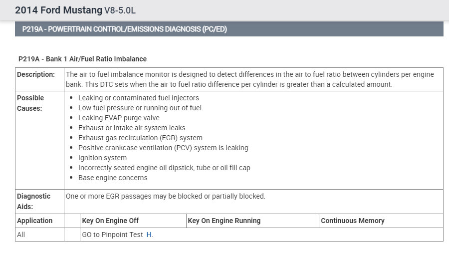

However, the code you have is specific to an air/fuel imbalance between the two engine banks. It can be caused by a few different things. For example, a weak fuel pump can cause it, an engine vacuum leak, or even an exhaust leak. Since you have installed headers, are the upstream oxygen sensors still present, and if so, are there any leaks in the exhaust pre-converter?
Do me a favor. Take a look at the pic I attached below. Note the list of possible issues/causes. Let me know if you have already checked the possible causes listed.

Hello, honestly, I have not checked any of those. The issue with the rough idle was before the header installation, but the P219A code first appeared about 2 weeks after replacing upstream O2 sensors. I replaced them in hopes of resolving the rough idle. I have been keeping an eye on my STFT while driving, and what I noticed was bank two was always lower than bank 1. When I put the car in neutral or park, I'll see the stft drop to about -30 and catch back up eventually. If tried taking the car to a mechanic but my car won't let their readers work due to the tune. And I can't revert to stock without removing parts. Seems like I've dug myself a hole, lol.

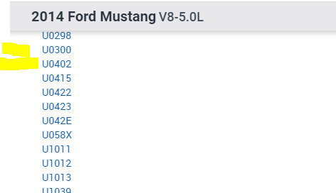

Hello, I'm back again. I had a new code pop up today and the CEL finally illuminated. The new code is a U401.
Oct 11, 2023 at 2:57 AM
  • 110,251 POSTS
Is it a U0401? If it is, that isn't even listed for this vehicle. I do know it is related to invalid information from the ECM. Please confirm that is the code.

Also, the code you provided should be a letter (U) and a 4-digit number. See pic below.

Hello, I apologize it was a U0401. Before this code showed up, I had some other weird codes pop up such as front wheel speed sensors invalid. I had both the battery and alternator tested and the battery was in fact bad. I replaced the battery and all my codes have magically disappeared.
