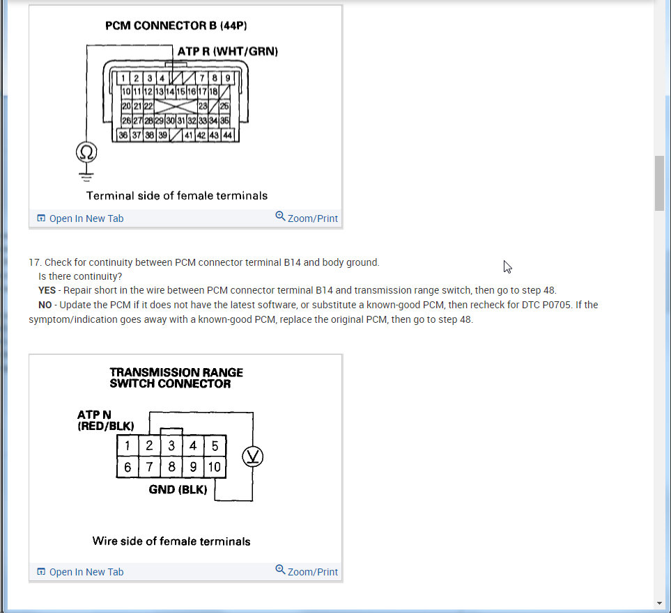

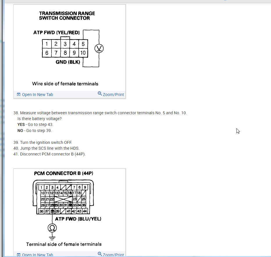

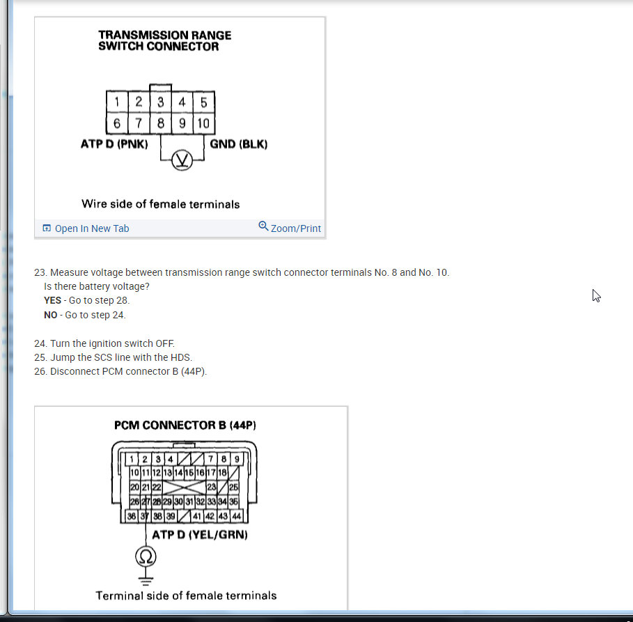

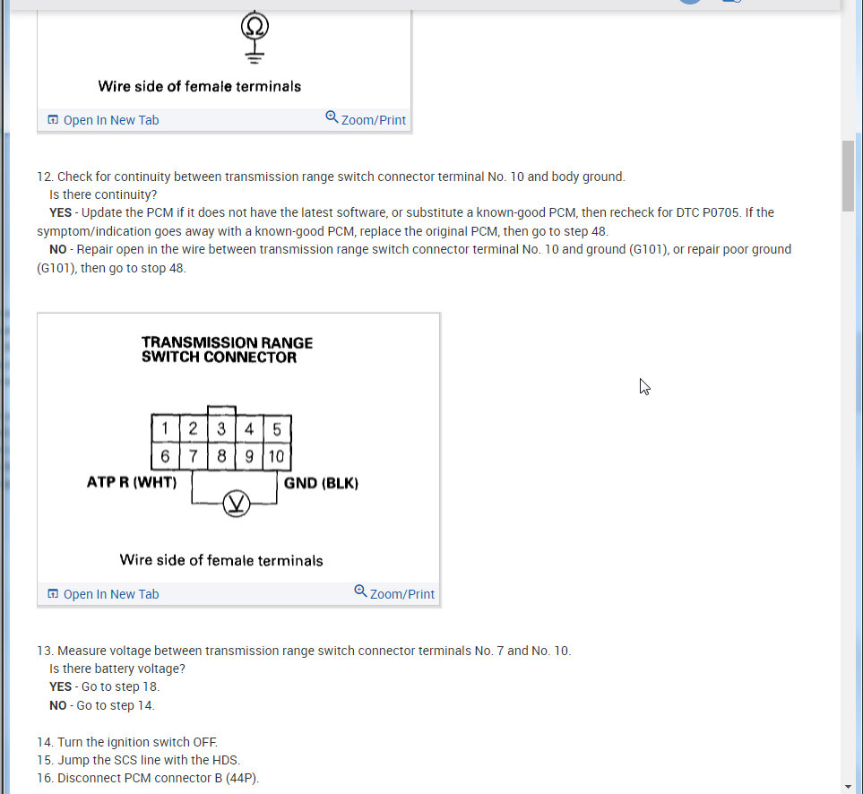

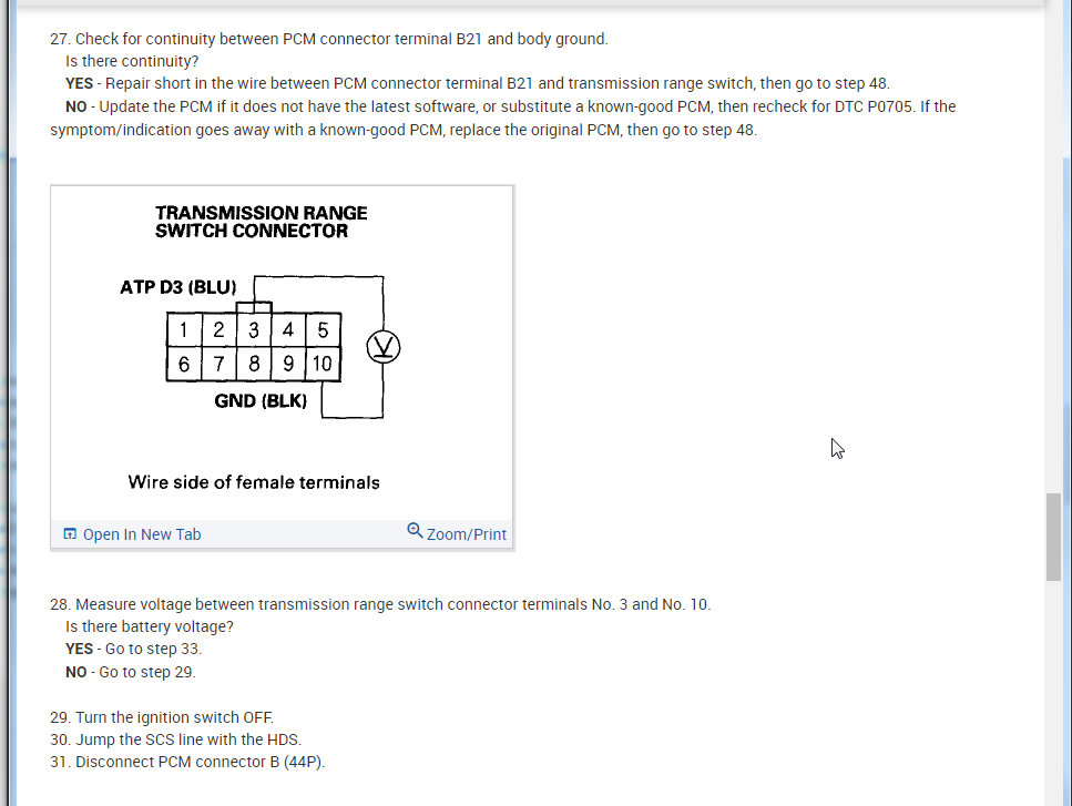

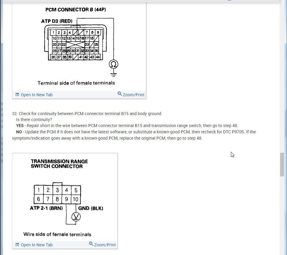

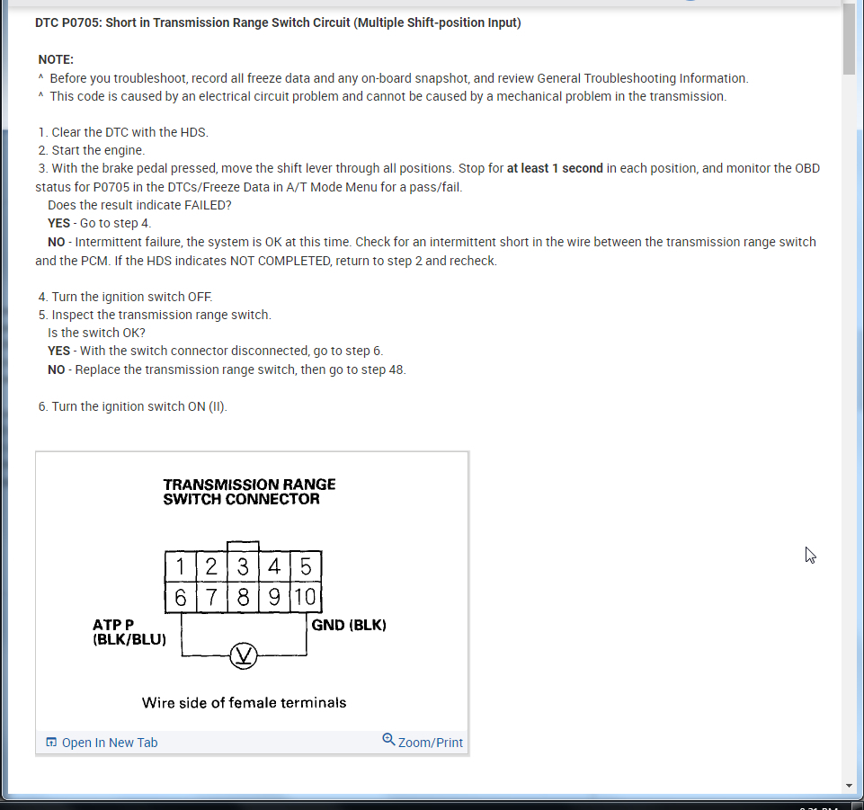

The D flashes when shifted into R. Returns to normal if ignition is turned off and restarted, only to return if shifted into R again. Everything else is fine, even shifting when driving. Code P0705 showing. Could this also be transmission pressure sensors instead of range switch? Also when in R, the R is lit, as is the flashing D together.
May 3, 2021 at 10:01 AM

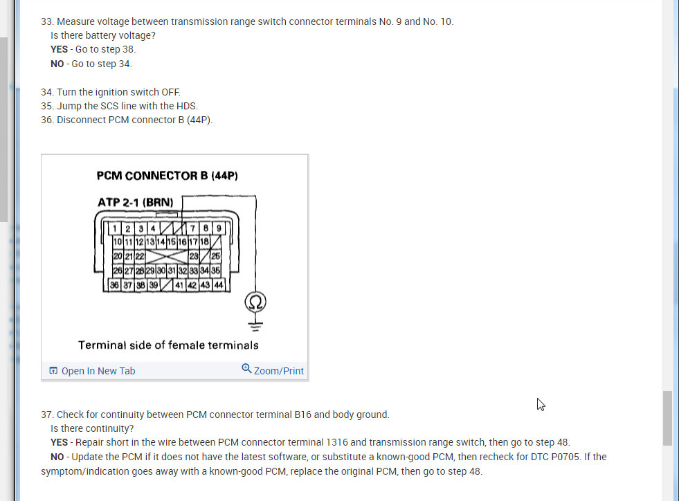

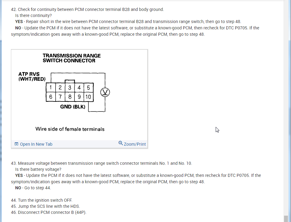

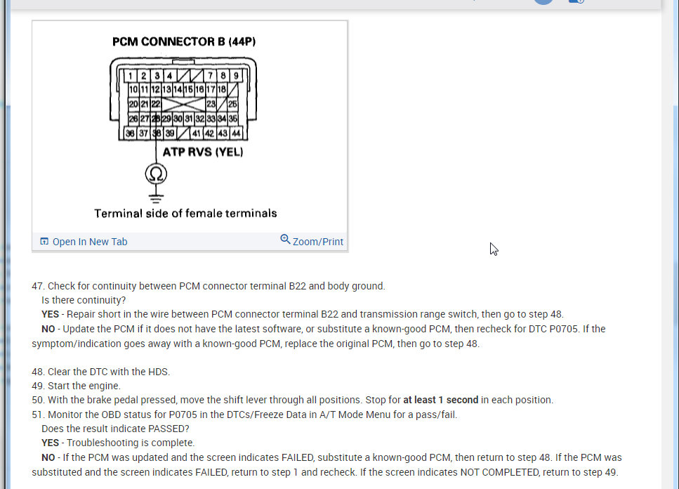

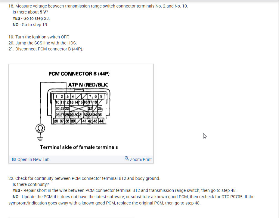

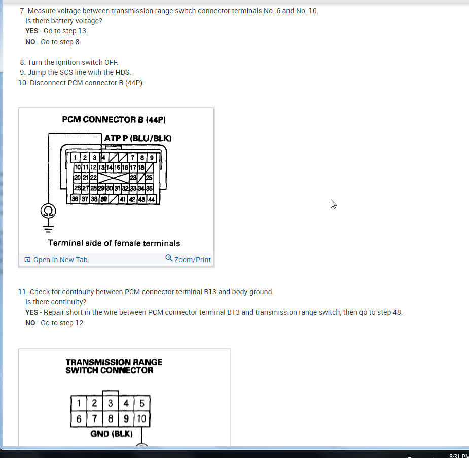

It is unlikely that the pressure sensor is causing this. The fact that you have this code that is related to the issue, we need to run through this testing and go from there.
Here is a guide that will help with this:
Please let us know if you have questions on this and we can go from there.
