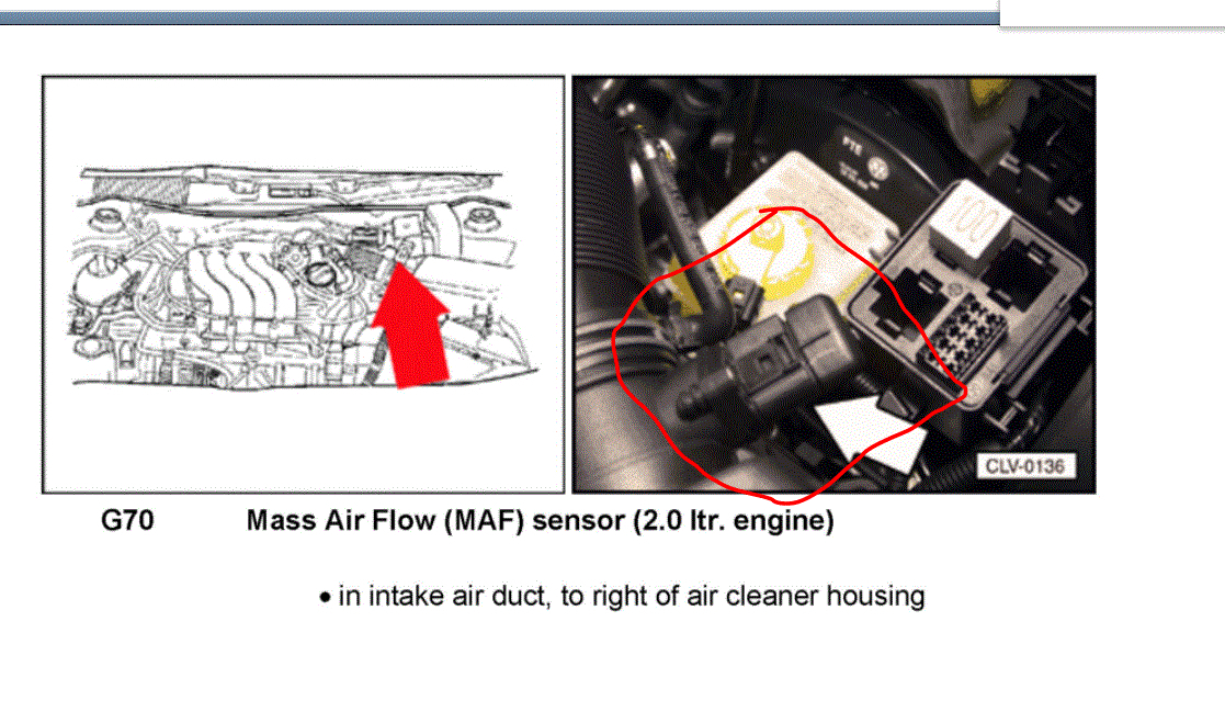

Okay, that looks like a lot, and to some degree, it is. However, there are two systems being affected. One is the evaporative emissions system (EVAP) and the other is related to the heated O2 sensor. The mass airflow is also affected, but it is indicating low voltage. The first thing to do is check the connection. Make sure it isn't damaged, corroded, or have a pin pushed in at the connector. If you look below at pic 1, I circled the MAF. Check that first.
Here is a link that shows how to clean a MAF. It may be a good idea to try this as well.
https://www.2carpros.com/articles/mass-air-flow-service

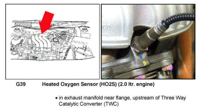

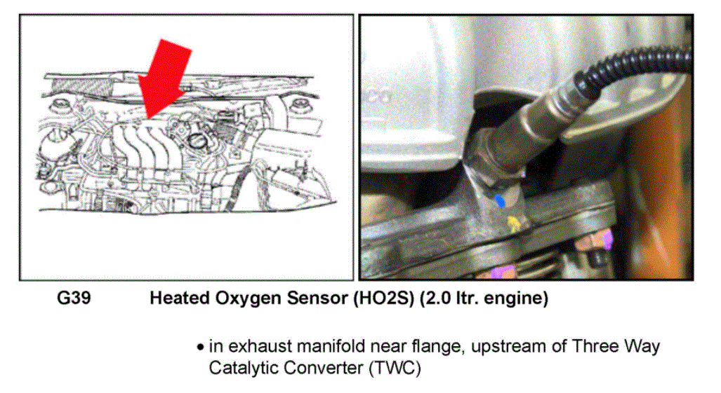

Next, see pic 2 which shows the location of the heated O2 sensor. Check to make sure it is connected because there is no signal.

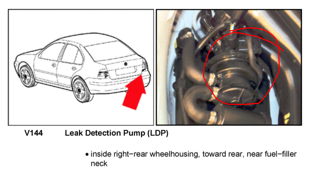

Pic 3 shows the leak detection pump. Again, there is a short to ground, so check the wiring to make sure nothing is shorted. Check the insulation on the wiring, remove the connector and check if the pins are damaged and touching, or anything indication a short.

The mass air flow sensor looks brand new along with all the other components and connectors.
