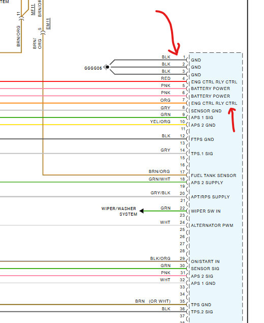

Nice testing, so the power is good and the grounds are good. Did you check the grounds to the PCM ? Here are the locations of the ground so you can check them out. You might as well check the power inputs as well, they are all together on the PCM. Let me know what happens.
Feb 25, 2026 at 11:26 PM
ANNS75
  • 22 POSTS
So I'm guessing you didn't read all of my replies. I was saying I did a voltage drop test on the map sensor connector and according to how they said to do it mine came up showing four volts on the ground wire of the sensor
Feb 26, 2026 at 1:23 AM
ANNS75
  • 22 POSTS
I will do the test you requested but if you're busy and only able to reply once every 24 hours I'd like to get as much info as I can and what the test and how... as possible. I'm disabled and this is my only vehicle I'm not able to go to any of my physical therapy or my other appointments so it's pretty imperative I get this fixed. It's getting down to the wire where my insurance will only pay for I think two more rides to the doctor so I'm trying to get this figured out ASAP. Not trying to bore you with my life story ,just stating my situation and the urgency. I understand you're busy and you're doing this for free and I really really do appreciate it very much.
Feb 26, 2026 at 1:30 AM
ANNS75
  • 22 POSTS
Also there's a couple grounding points inside the car that I did not locate are you able to get a picture diagram of their exact location I know they're on the driver's side but I don't know if they're under the carpet or under the panels It was very unclear and I was not able to test those grounds. In the engine compartment I got the ones on the driver and passenger towers , 2 on dr. Side tower by ECU,the strap, the one under the coolant the one on top of the transmission are there any I missed?

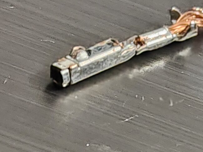

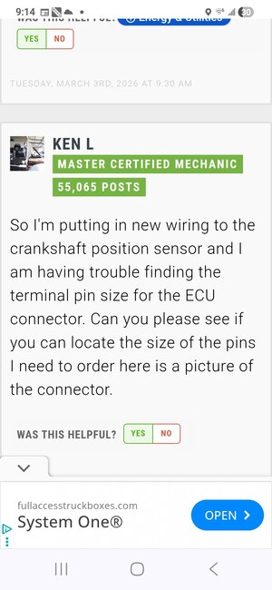

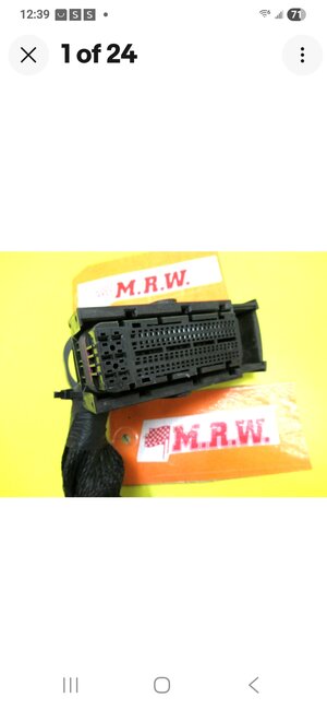

So I'm putting in new wiring to the crankshaft position sensor and I am having trouble finding the terminal pin size for the ECU connector. Can you please see if you can locate the size of the pins I need to order here is a picture of the connector.
Mar 9, 2026 at 7:03 AM
ANNS75
  • 22 POSTS
Approximately 2mm squared x 16 mm long
Mar 9, 2026 at 11:13 AM
ANNS75
  • 22 POSTS
Also this was the last post I got from you which was verbatim what I sent you I don't know what happened there.
Mar 9, 2026 at 11:15 AM
  • 55,433 POSTS
It looks like that is your response. The webmaster of the website fixed it.
Mar 10, 2026 at 12:58 AM

What I recommend ordering
Look for:
0.64mm ECU terminal pins 20-22 AWG
or
Bosch / Hyundai ECU Micro-64 terminals
Those are the ones most harness builders use.
