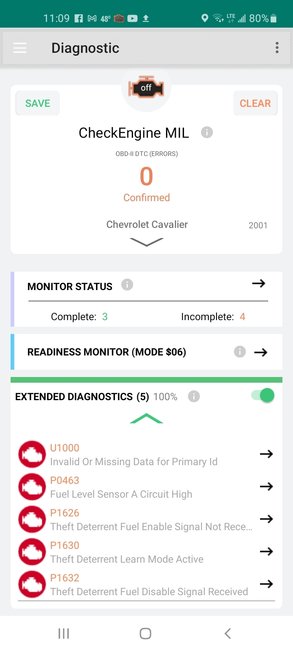

It didn't work. I clear the codes and the first time I turn the key off to on the check engine light comes on I'm assuming the u1000 code is popping up whatever that is.
Apr 17, 2021 at 7:02 AM
  • 110,240 POSTS
The U1000 basically indicates the control module is not receiving signals from other modules. Take a look through the two pics I attached. Let me know if that helps you or if you have other questions.

Did you change the ignition lock or anything? The 1626 indicates the body control module isn't enabling the fuel circuit (anti-theft/key not recognized) 1630 indicates the PCM is in the password learn mode, and 1632 indicates the PCM has received a fuel cut-off password from the BCM or an undecided password which could mean there is no communication.
The problem could be the switch/passkey, something different in the new harness, a faulty body control module, faulty PCM, and so on.

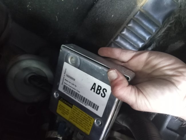

So I found this (see attachment) but it says ABS and the plugs are different so I don't think it's it.
Apr 19, 2021 at 10:30 AM
  • 110,240 POSTS
No, that isn't it. It should be under the dash on the left side.

So every video I watch and everything I read shows me that the BCM is behind the fuse box and back a little bit. That ABS thing I showed you is where the BCM should be, so I am a little bit confused about that.
Apr 20, 2021 at 12:21 AM
WOODBOB690
  • 28 POSTS
Could it be in the ABS thing? I think I read somewhere that it's a EBCM the ABS is built into it.
Apr 20, 2021 at 3:37 AM
  • 110,240 POSTS
That is possible. I attached two pics below from the manual. One indicates the BCM and the other the EBCM. They look like they are in the same place.
