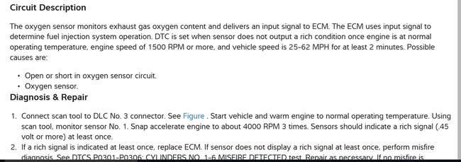

I have a trouble code of PO125 and need to know what I need to change.

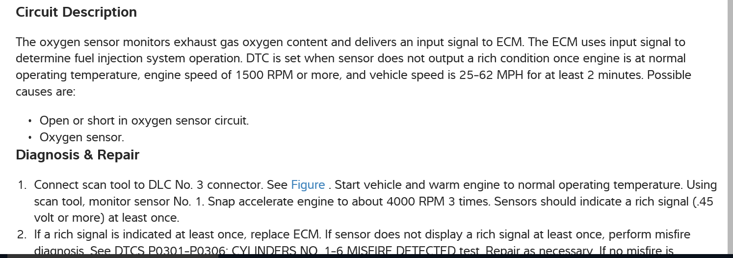

You need to check oxygen sensor in front of catalytic converter. The coolant temperature is too low to go into closed loop. See picture on how to test it.
