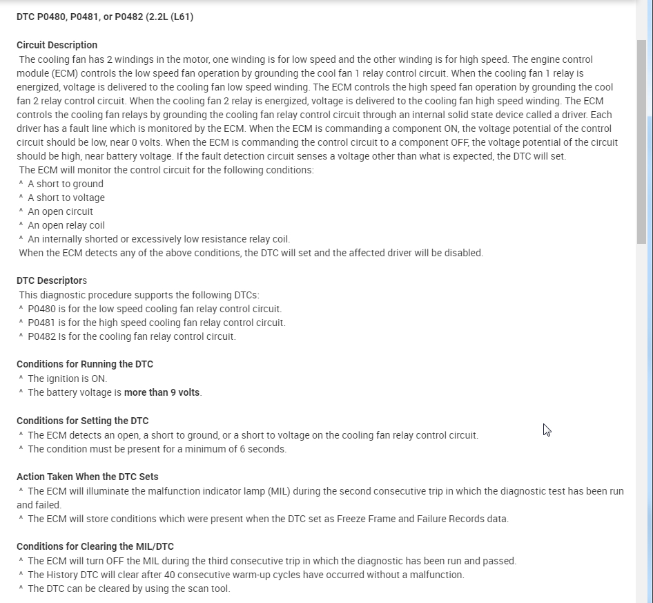

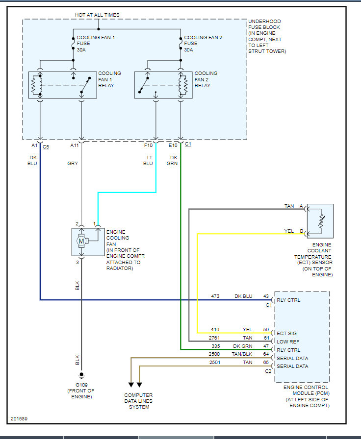

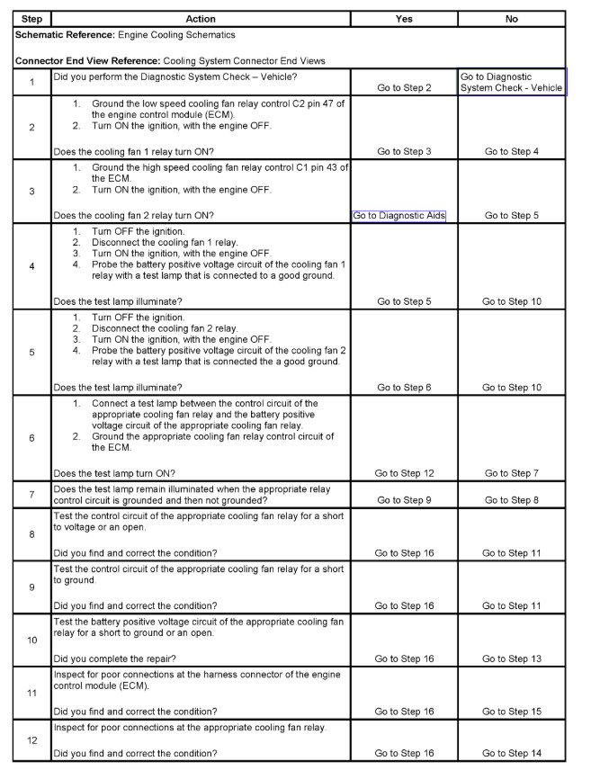

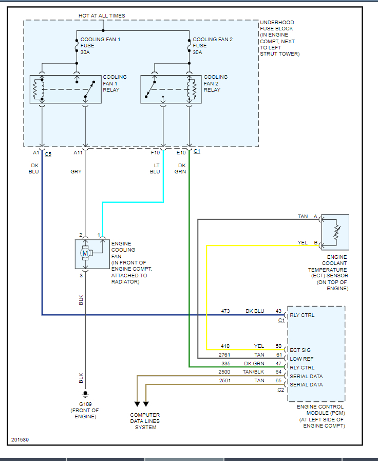

Engine light shows trouble p0480. by the way how many relays are on my car for the cooling fan? Thanks
Dec 9, 2019 at 6:45 AM

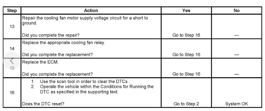

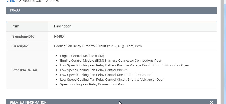

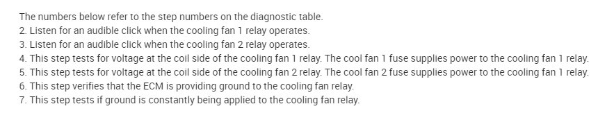

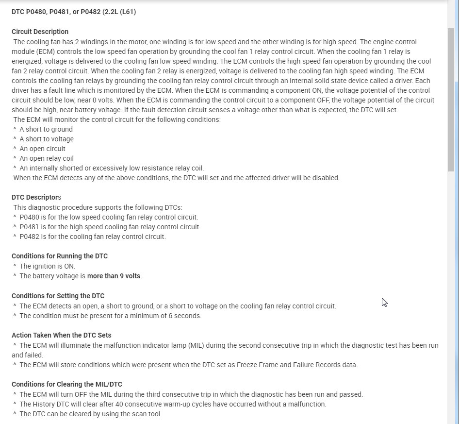

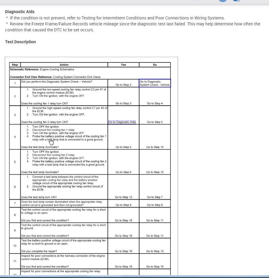

I attached the test for this code so you can run through it and let me know what you find. I attached the wiring diagram. You have two fan relays. Let me know what questions you have if any. Thanks
