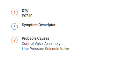

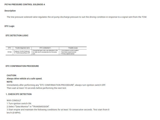

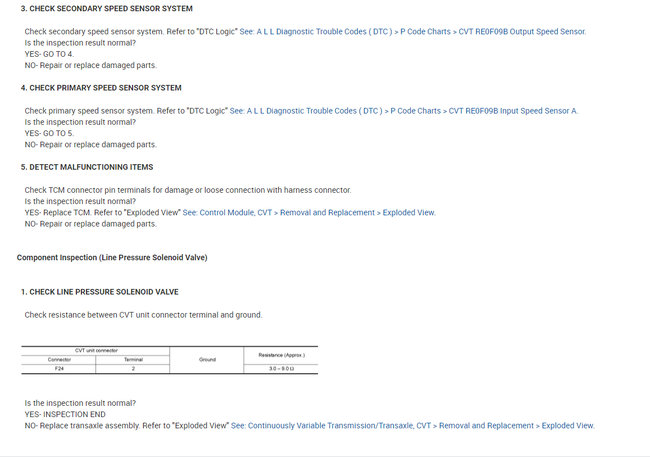

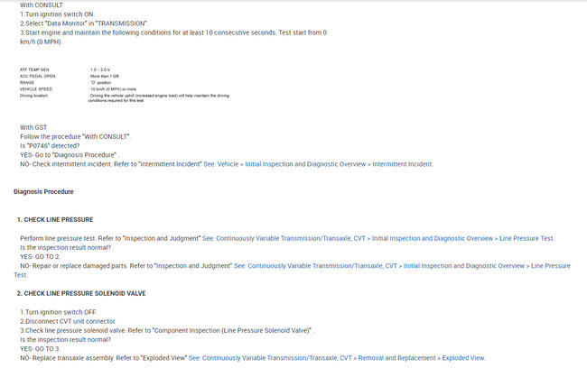

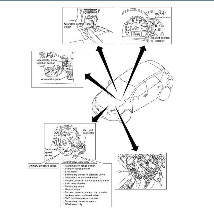

Good afternoon,
I attached the possibilities and the flow chart for you for the code.
In most cases, it is the transmission that is the issue. I know it is beyond the warranty but it looks like you may be doing it again.
The pressure control solenoid is external but rarely is the failure. You will need an advanced scan tool to monitor the action of the solenoid.
