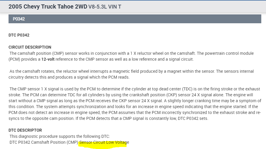

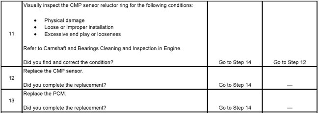

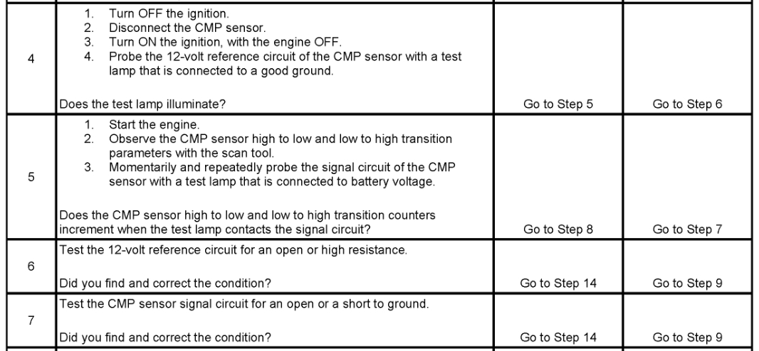

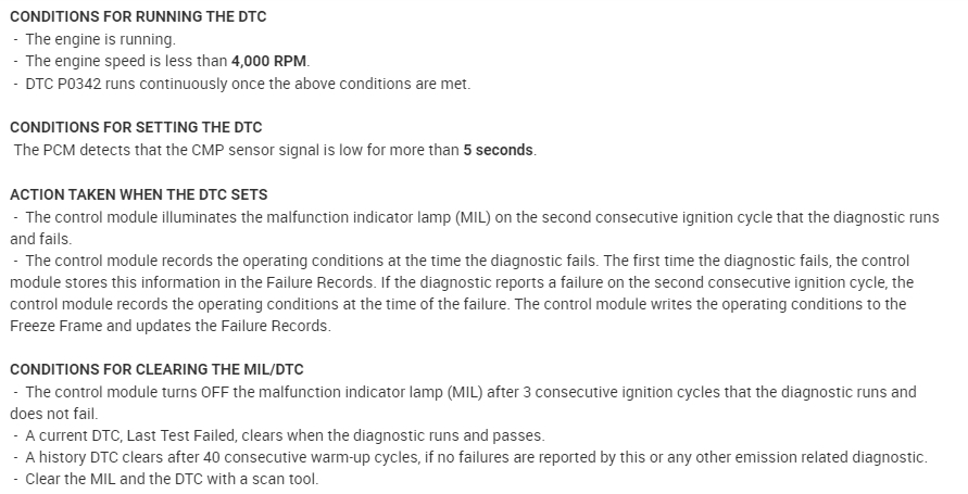

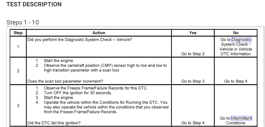

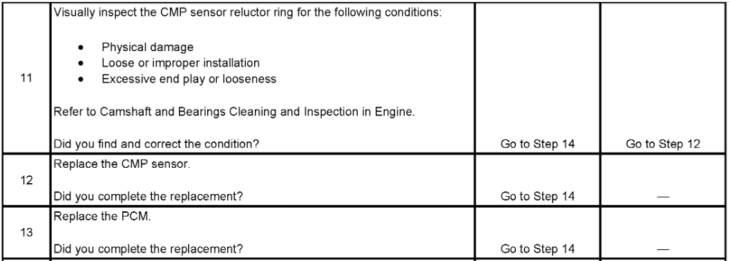

Hello. Any suggestions? I replaced both my camshaft sensor and crankshaft sensor and I’m still getting the code P0342 with start up trouble. What should I do next??
Mar 7, 2023 at 12:41 AM
  • 110,244 POSTS

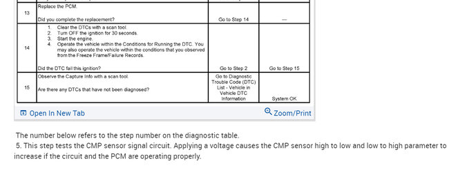

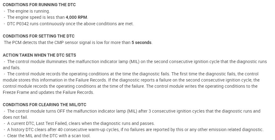

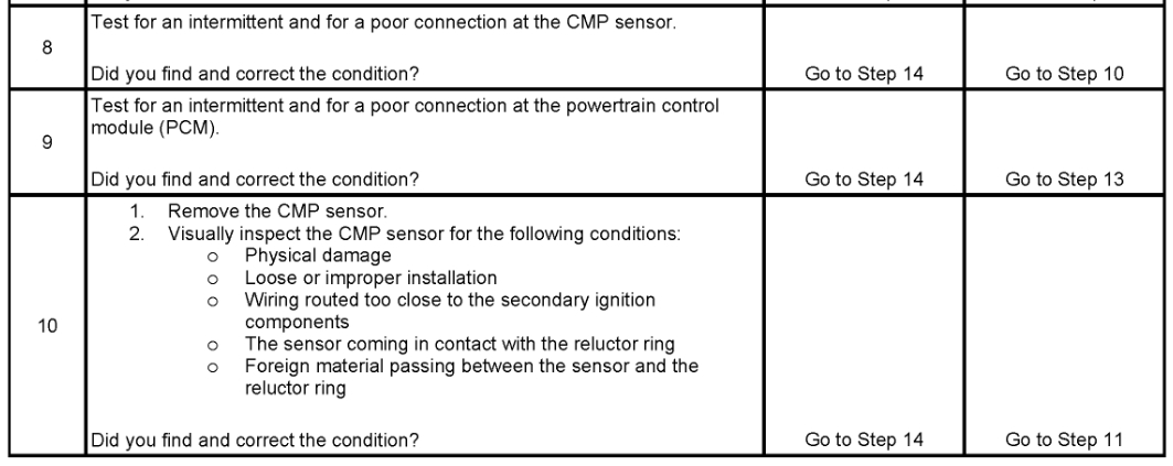

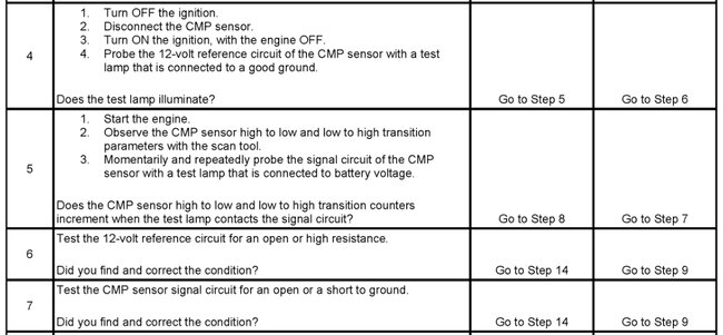

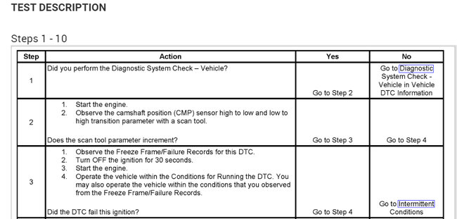

The code indicates a low voltage issue to or from the sensor. In this case, it can be a connector issue, a broken wire, a short-to-ground issue, or even a failing PCM.
I don't know what type of tooling you have, but if you have a live data scan tool as well as one that can look up freeze frame data, I attached the diagnostics below specific to this vehicle. Take a look through them and let me know if you are comfortable performing them.
