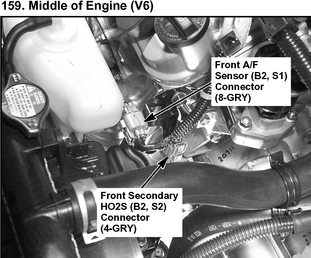

I checked for a code and reader came up with P0134/Air-Fuel Censor Circuit-No Activity. What sensor[s] should I suspect?
Feb 24, 2015 at 7:21 AM
  • 110,244 POSTS
see attached pic. I found it online. Let me know if it helps. Before replacing the sensor, make sure there are no wiring issues and the plugs are not damaged or corroded.
Feb 24, 2015 at 10:01 AM

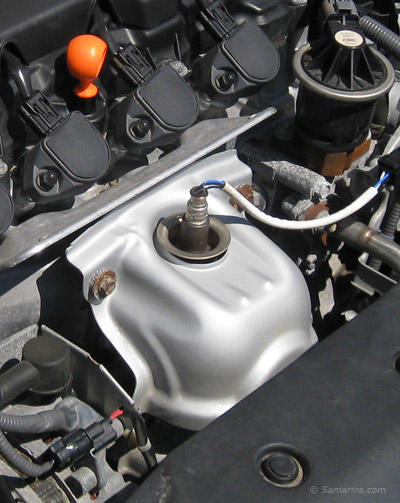

In the questionaire about the year, model,ect. , I'm sure I typed that
it was a 4; that's four cyl., but's that's okay, your reply is sending me
looking for a loose or corroded connector. Thank You! Grovis
Feb 24, 2015 at 4:32 PM
  • 110,244 POSTS
I'm sorry, yes you did say a 4 cylinder. That was my mistake. See if this helps.
