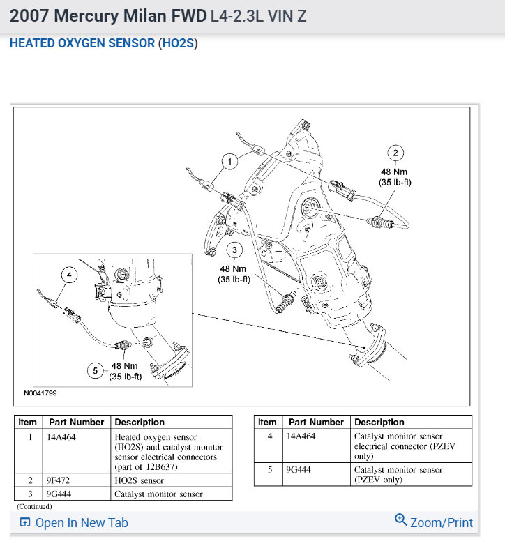

hello, i recently replaced the exhaust manifold converter along with two brands new ngk oxygen sensors and my wife called and said that we have a P0133 code on. need some help.
Sep 10, 2023 at 11:03 AM
  • 55,433 POSTS
The code number is because of slow response from the sensor, the diagnostic trouble code (DTC) P0133
P0133: Oxygen Sensor Circuit Slow Response (Bank 1, Sensor 1)
I would say you have a defective sensor, but I would try clearing the codes and try it again in case it is a glitch in the system, or the new parts are recalibrating and it needs more time. Here is the location of the sensor so we can be on the same page. Check out the images (below). Please let us know what happens.

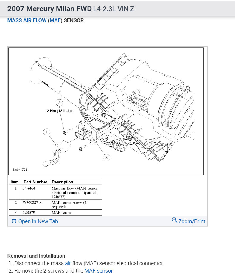

Need help.
Sep 15, 2023 at 3:13 PM
  • 55,433 POSTS
Yep, I have seen the MAF sensor cause this problem. I would swap it out and then clear the codes. Check out the images (below). Please let us know what you find.
