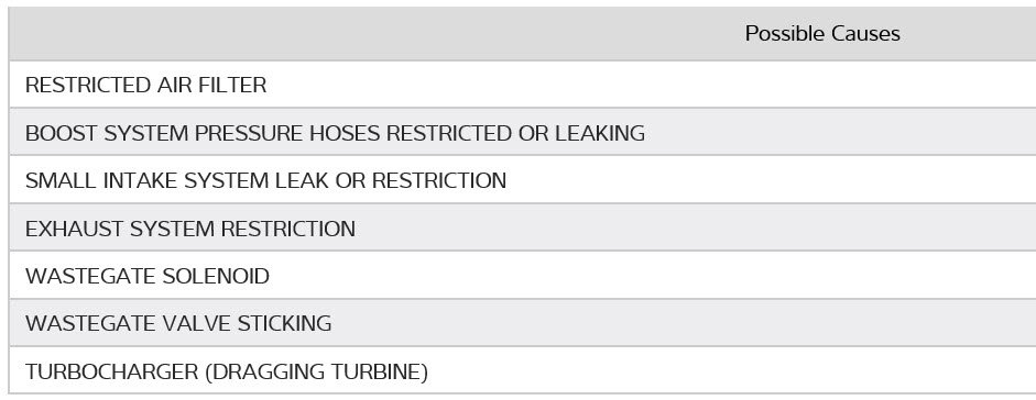

I have a p0229 turbo under boost code come up. when the code is active turbo does not boost full pressure. trying to find out how to fix it.

we do not list code 0229. it is code 299. see picture for causes.
Image (Click to enlarge)
