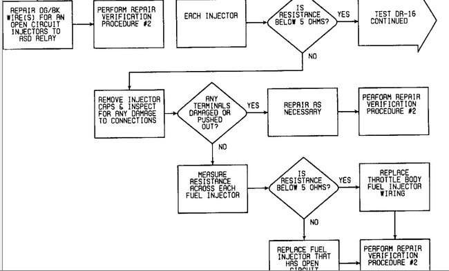

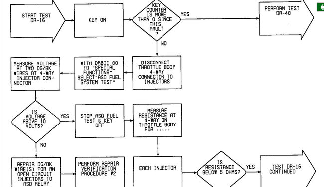

Hello again, I swear I think this truck hates me. Lol. I drove to work this morning and it drove just fine. I go jump in it at lunchtime and it starts up but idled badly, has no power, and wants to backfire when I push the gas pedal to far. I did the key dance and Code 27 pops up. Help please!
Apr 25, 2017 at 3:17 AM
HMAC300
  • 48,601 POSTS

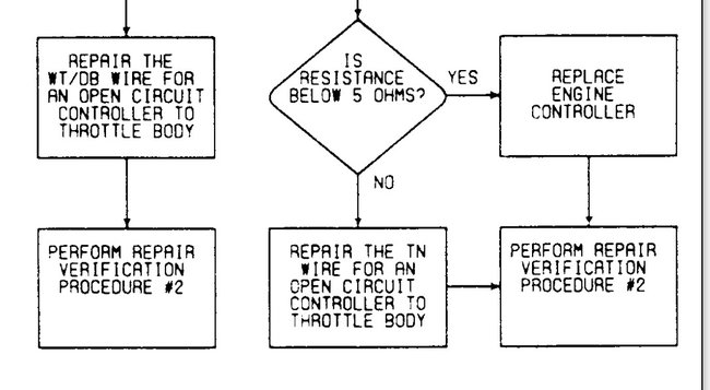

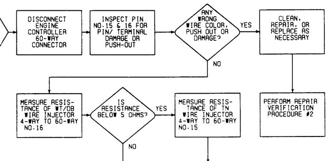

see pictures for diagnostics it may be an injector problem or an ECM problem or connection. follow first picture on left then to others.
