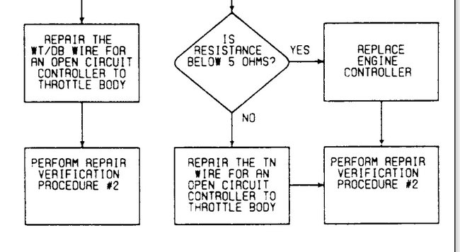

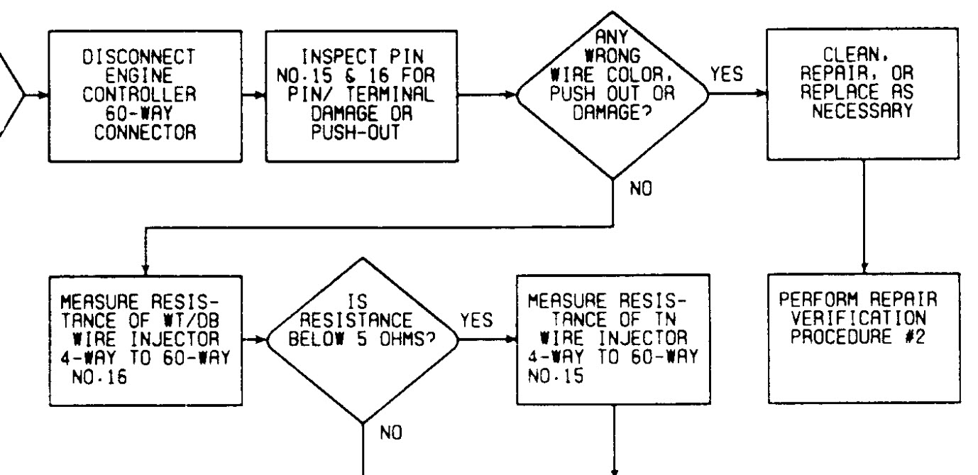

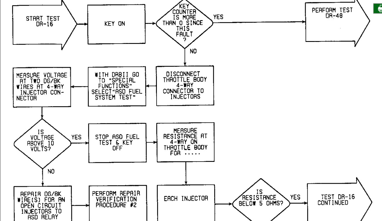

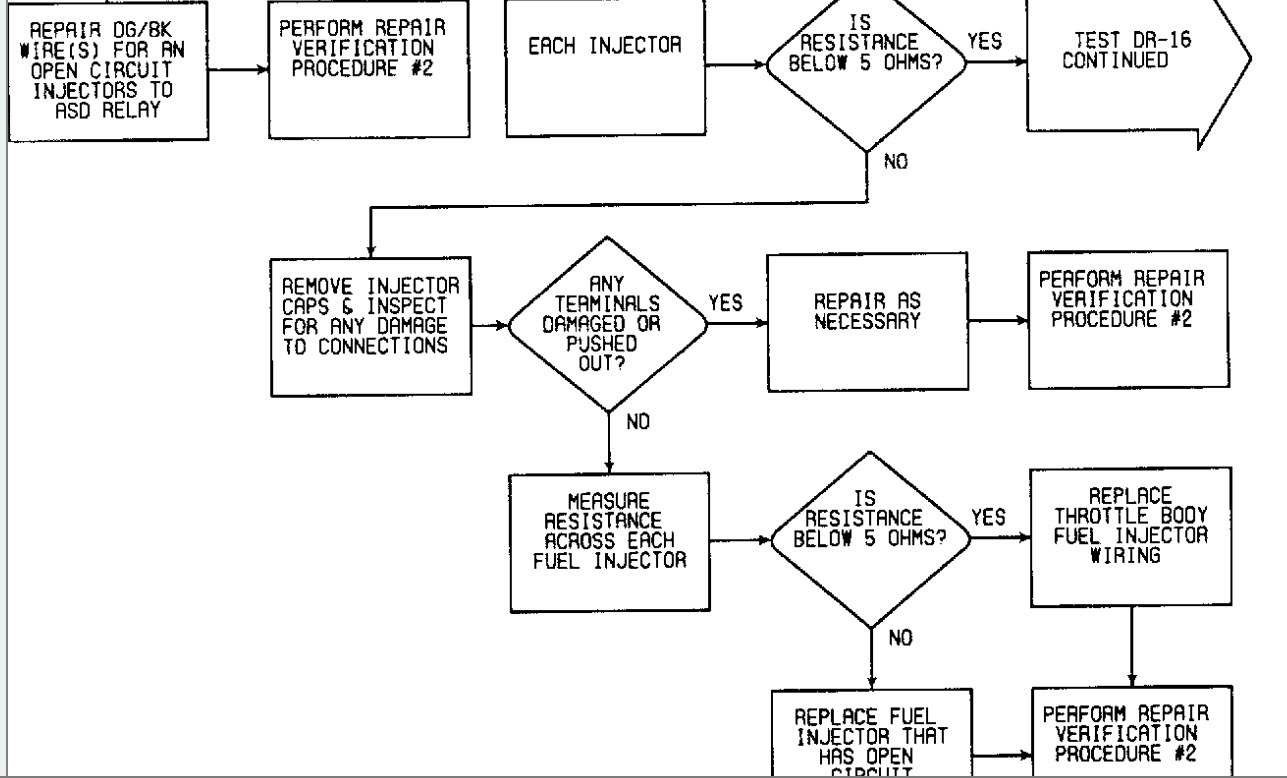

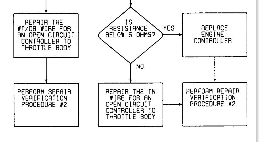

Hello again, I swear I think this truck hates me. Lol. I drove to work this morning and it drove just fine. I go jump in it at lunchtime and it starts up but idled badly, has no power, and wants to backfire when I push the gas pedal to far. I did the key dance and Code 27 pops up. Help please!

see pictures for diagnostics it may be an injector problem or an ECM problem or connection. follow first picture on left then to others.
