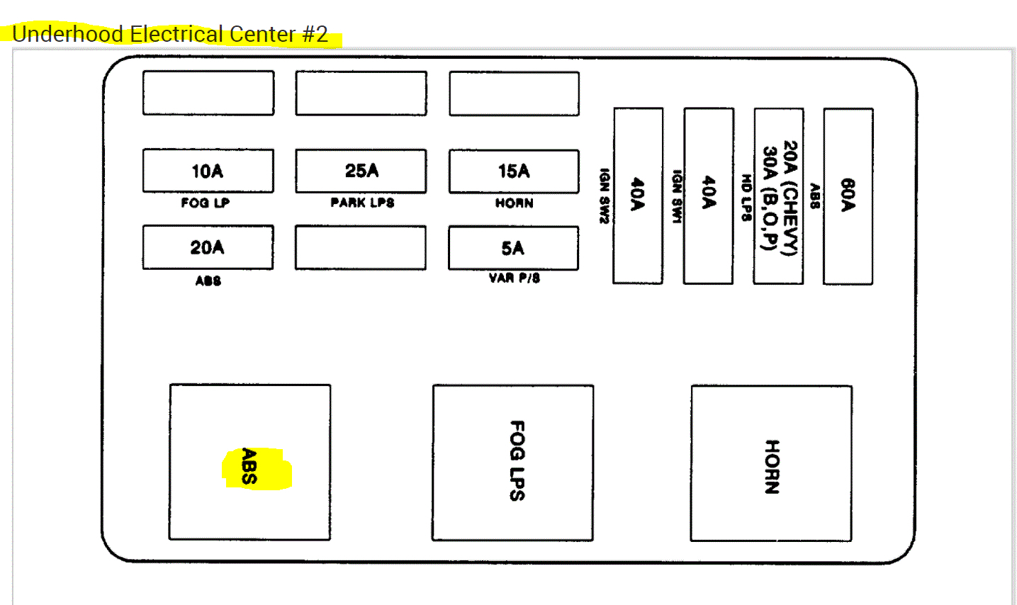

I need some help figuring out what are codes C1214 and C1286 and how do i fix these codes.
May 23, 2021 at 1:22 PM
  • 110,240 POSTS

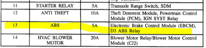

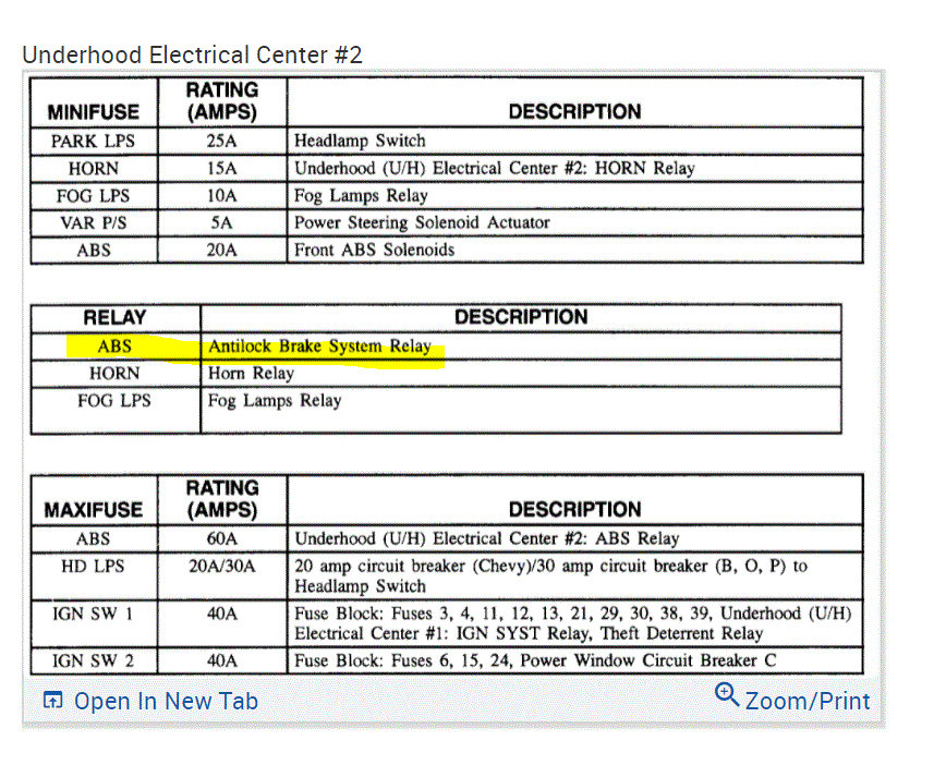

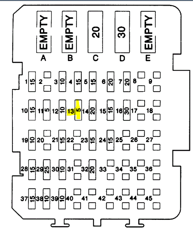

The codes are all related to the ABS system. The actual GM codes for this are 14, 17, and 18.
If you look below, I highlighted a fuse to check and a relay. The relay is under the hood in the fuse/relay box. Make sure to check the fuses in that box as well. If there is another relay with the same part number, switch them to see if it makes a difference.
The fuse is in the interior fuse panel. Check it as well.

put a brand new fuse and relay like you told me . now i hooked up the code reader and i'm getting code c1287.

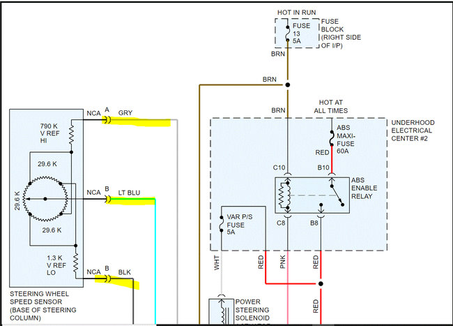

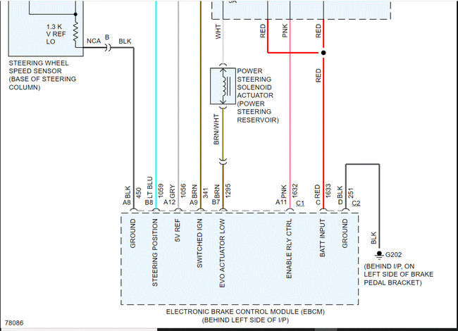

The other codes went away after I change the fuse and relay... I deleted the code and it seems to be stuck on the c1287 code. do you think the steering wheel sensor plays a part with this code?
Jun 8, 2021 at 3:56 PM
  • 110,240 POSTS
It is very possible. I attached the wiring schematic below. It's cut into two parts to make it readable. The sensor should be near the bottom of the steering column. I don't know if it's because of the model year or what, but I have no diagnostics for it. So, we have to do the best we can.
If you look at the schematic, I highlighted 3 wires in the first pic. The gray wire at the top should have a 5v reference from the EBCM. The black wire at the bottom (low reference) should show continuity to ground. The light blue should show voltage changes when turning the wheel.
Let me know what you find.

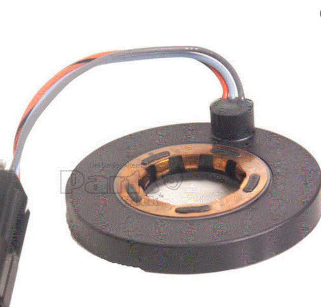

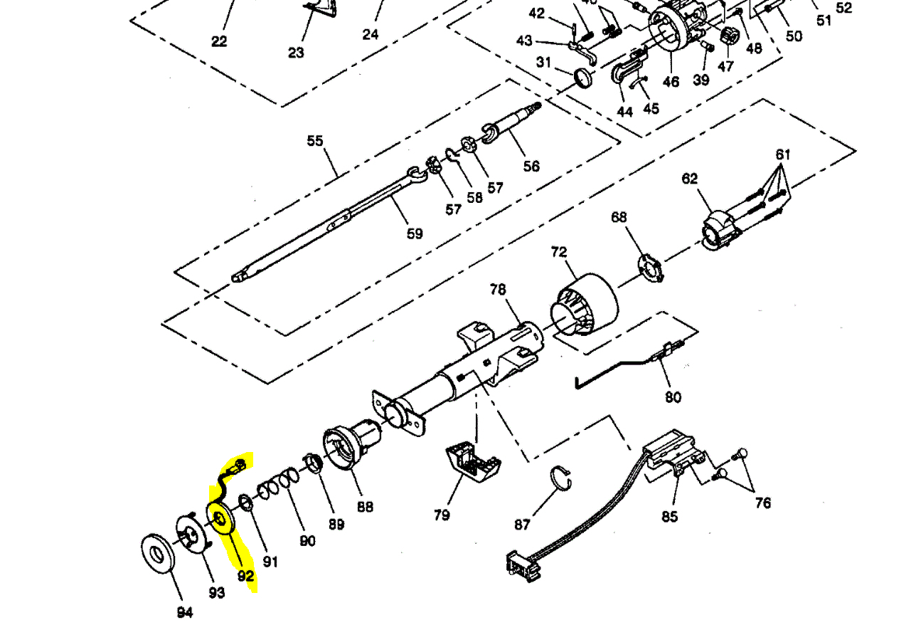

where is the steering wheel speed sensor or position sensor located at?
Jun 13, 2021 at 5:47 AM
  • 110,240 POSTS
It is near the bottom of the column and the steering shaft goes through the center of it. If you look at pic 1 below, it shows an exploded view of the steering column. I highlighted the sensor. Pic 2 shows what the component will look like.
Let me know if this helps.
