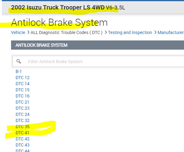

Hi Joe, sorry about the delay in answering. No data reader, I am at the mercy of the automotive shop. I am trying to research it because they seem to be at a loss. My ABS light recently came on And I am waiting on an appointment to have the right front holding solenoid replaced, they said it was Code 40 on ABS dash light. This is only light that has been on, and code found.

The interesting thing about what you have been told related to the ABS, from what I see is that isn't a code for this year and model. See pic below. Maybe they made a mistake.

I spoke with the shop on Friday. Mentioned there is no code 40...they looked up the record and it is code "43". I do not have access to a code reader, and the shop says that's the only code it throws. I will update you after they have it in this week. It sounds to me like the issues you mention should be remedied by the shop. I will update soon. Thank you again, Joe!

Code 43 is an ABS code. There is an issue with the electronic hydraulic control unit (EHCU). I don't feel this would cause you to have power issues.
