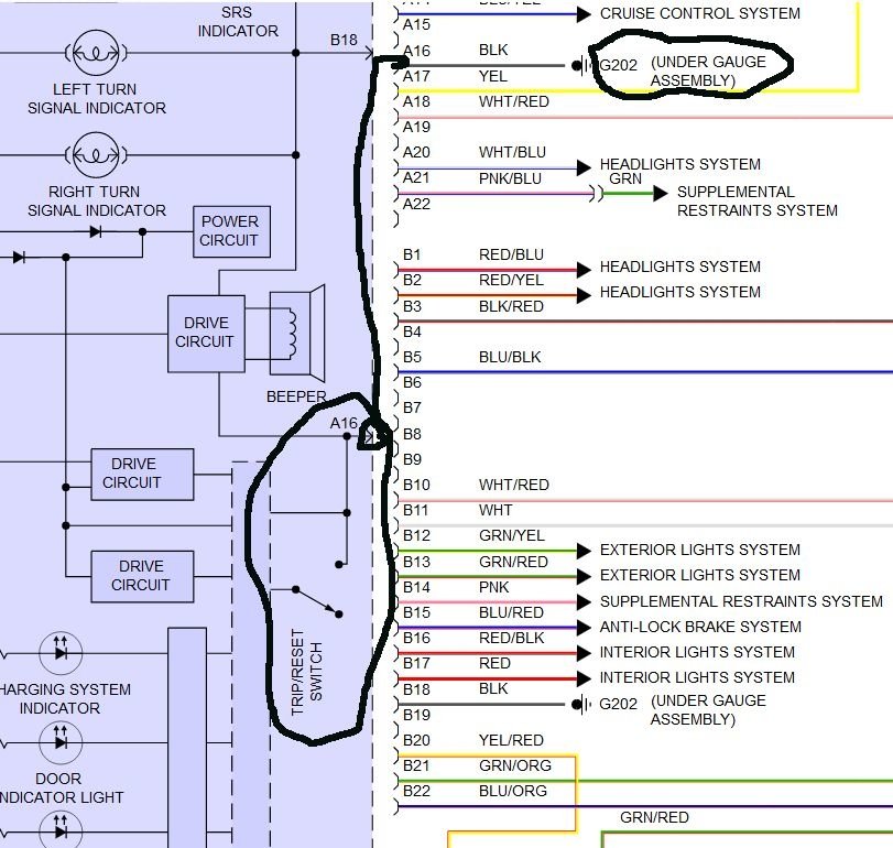

Problem is that the trip button will not toggle between Trip A, Trip B, or total mileage. My display is current actual mileage and the button in non-functional. The button will not toggle the display. Hope this clarifies my issue.

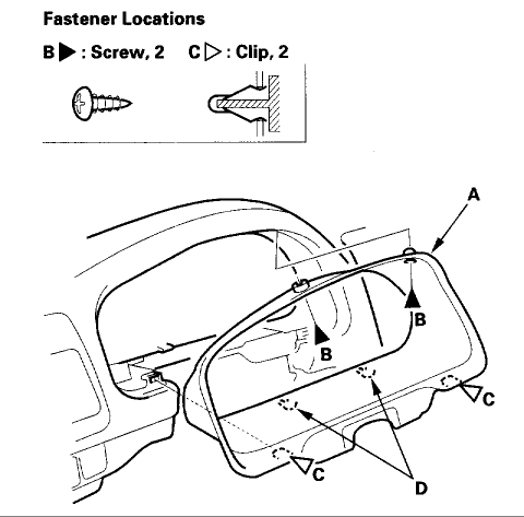

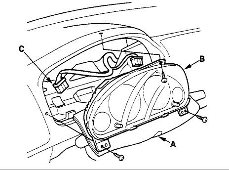

Okay, the button itself has failed. That could be a bad solder joint or failed switch. It pulls a line on the gauge cluster CPU to ground to toggle the readings and reset the warning. If the other warning lights come on during the bulb test and the odometer is working it is not the ground that is the problem. It is the switch itself. You have a couple options, remove the instrument panel, strip it to the board and repair the switch by soldering in a new switch or repairing the old one. Or you could get a replacement, but they are not cheap.
