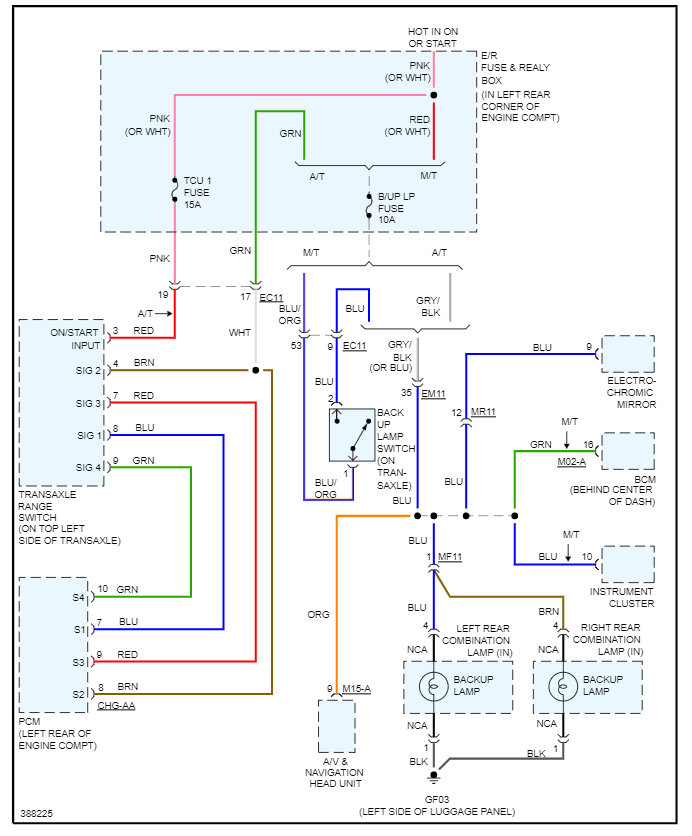

I'm trying to install a backup camera; what color is the trigger/reverse wire in the taillight?

It looks like it changes color depending on where you will intercept the wiring at. here are the reverse light wiring diagrams so you can see what color the wires are in a particular location. Check out the images (below). Please let us know if you need anything else to get the problem fixed.
