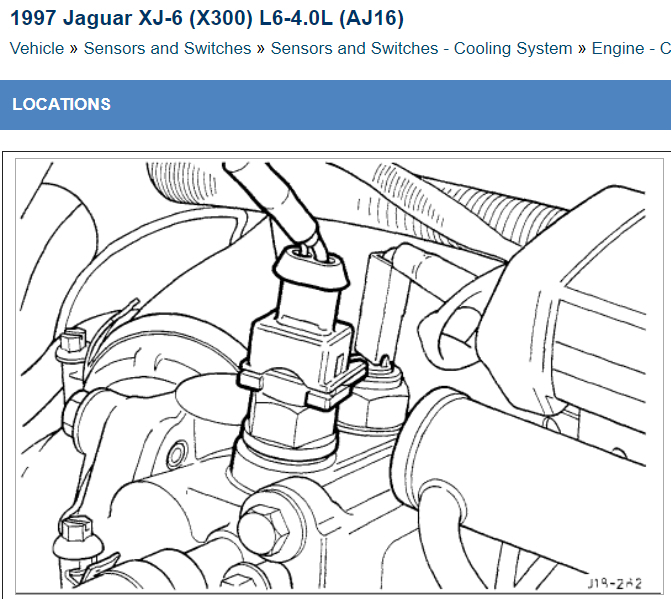

Thanks. Car has now started and is running okay, now the engine overheat light is lit up. The gauge with the arrow is working along side it. But of course does not read 'hot'. I am thinking the temperature sensor/sending unit may be at fault?
Apr 8, 2018 at 3:30 AM
  • 55,402 POSTS
It sure sounds like it and they had problem with these sensors all the time. Here is a guide to help you see what you are in for when doing the job.
https://www.2carpros.com/articles/coolant-temperature-sensor-cts-replacement
Here is the location for your car.
