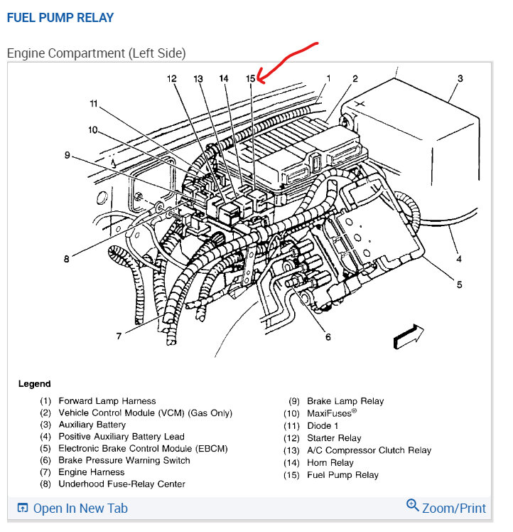

When you turn the key on without cranking the engine over can you hear the fuel pump run in the tank for about 5 seconds? If not, you can help a defective fuel pump, or I would swap out the fuel pump relay which is located under the hood.
Please check out this guide:
https://www.2carpros.com/articles/car-not-running-advanced
Please check out these guides and get back to me, the fuel pump relay I have included in the images below.

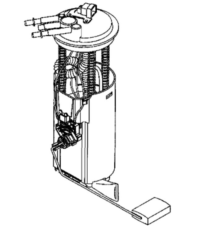

Sorry about your predicament. Do you have a new fuel filter? If so, it sounds like the pump has gone bad, here are the fuel pressure specs.
Key On Engine Off .................... 60-66 psi

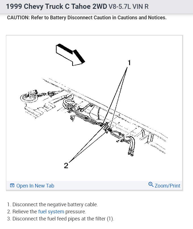

Here is a generic guide to help you step by step with instructions in the diagrams below to show you how on your car:
https://www.2carpros.com/articles/how-to-change-a-fuel-filter

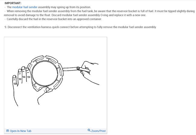

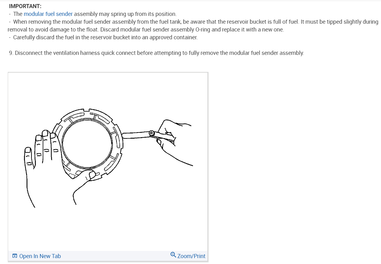

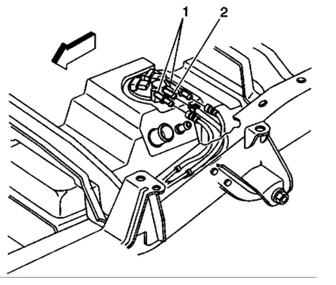

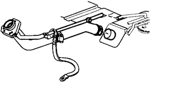

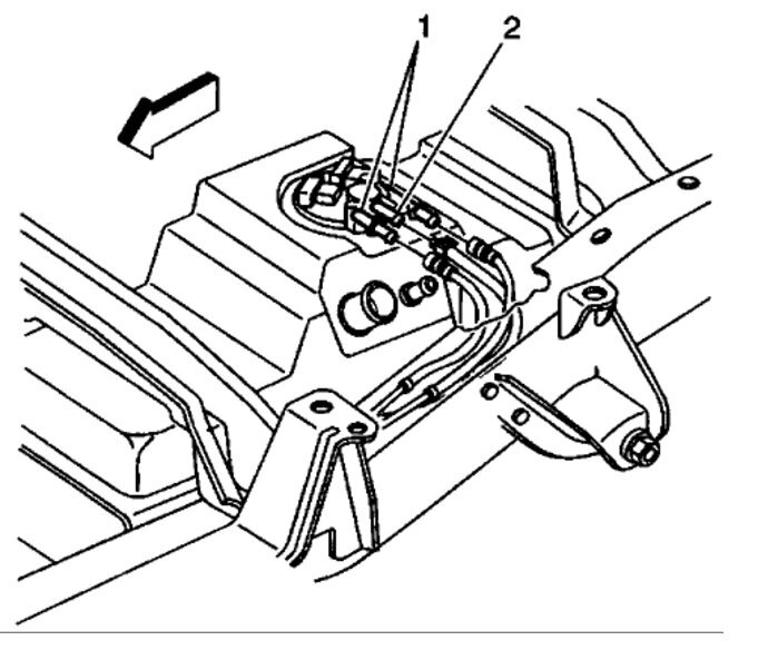

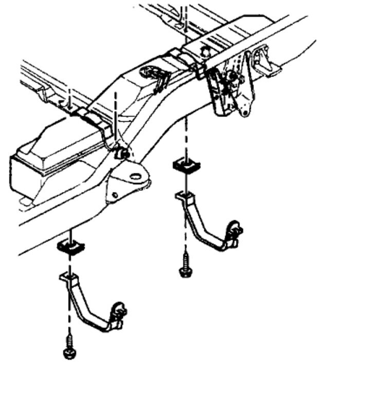

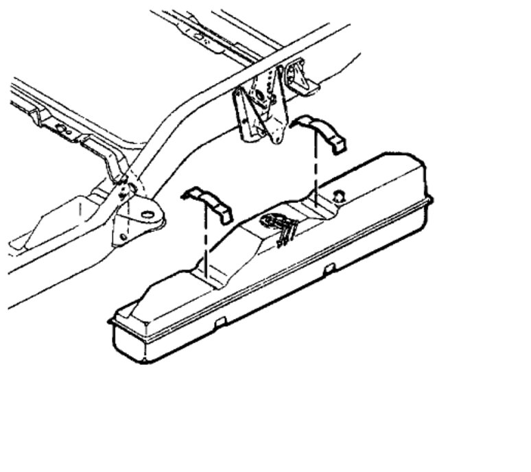

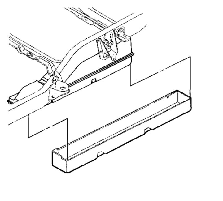

Here is how to change the pump out. Check out the images (below). Please let us know how it goes.
