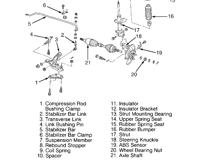

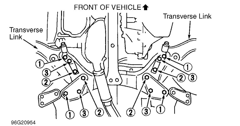

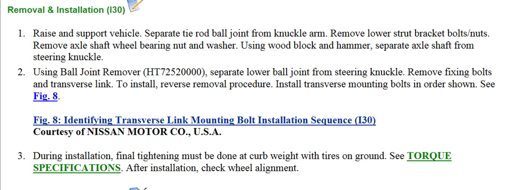

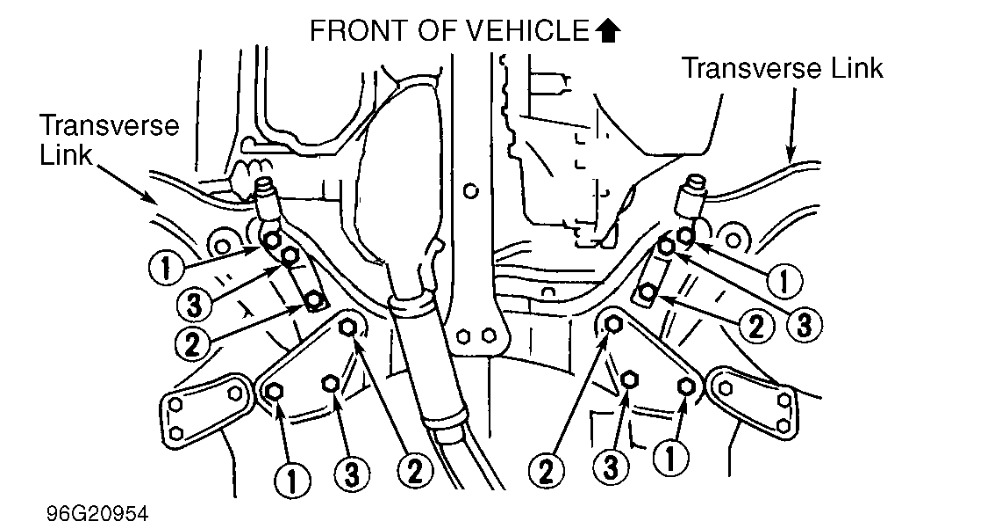

I am going to replace the front lower control arms, dose the bushing pin come out of the bushing after I take off the lock nut off. And will it fit in the new metal type bushing. I really mean does it come out easy with torching it.
Aug 13, 2014 at 12:50 AM
HMAC300
  • 48,601 POSTS
see pics after control arm is out then you shold be able to pull the roded part out as well. but it may come as an assembly from what I can see on rock auto it's an assembly and bushings are already installed along with ball joint
