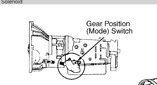

Lost all forward gears, reverse still would work. So, I take the transmission out and have it rebuilt at a local shop. I get the transmission back and reinstall it. I have reverse but no forward gears still! Argh!

did you scan for codes first? may be the mode switch which tells it which gear to put it in. See picture.
