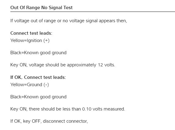

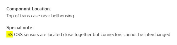

The drive and neutral lights flash. When checking the code, it says that it is the transmission input speed sensor. If I clear the code the car drives fine until it comes back on. We have replaced both the input and output speed sensors, and we have checked for leaks or damage but nothing. The fluid is full but does need to be changed. What else could cause these issues? With trying different things to fix it the car has been driven some. Sometimes for several smaller trips with no issues and sometimes it will have the same issue several times before going around a city block.
What can we do next to try and diagnose/fix the problem?

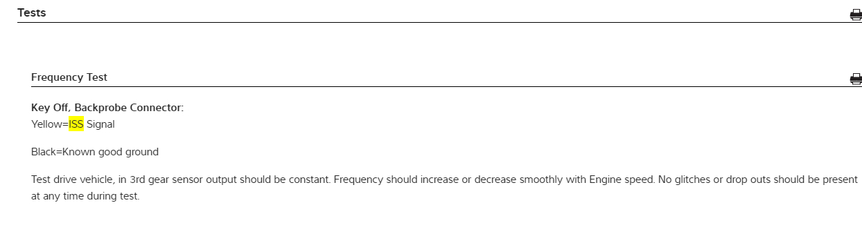

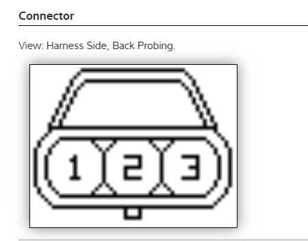

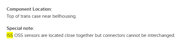

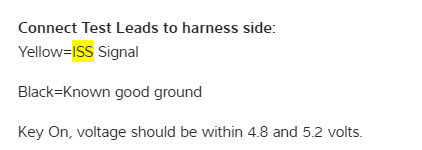

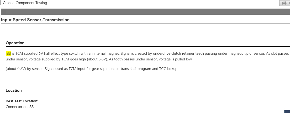

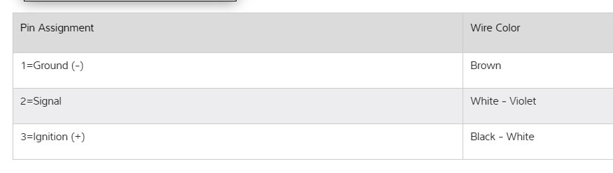

If you have replaced the sensors and there has been no change, chances are we have a poor connection either in a connector or a damaged wire in the harness. That would explain the length of time differences as to when it happens.
Here is what I need. Let me know what specific code was retrieved. If I have that, I can read the exact definition and determine what may be causing the issue.
Dec 5, 2022 at 6:22 PM
NCOOP
The code reader shows "P0715 Input/Turbine Speed Sensor A Circuit".
Dec 5, 2022 at 9:17 PM
  • 110,194 POSTS
Okay, if the sensor was replaced with no change, there is likely a wiring issue.
I attached the diagnostics for the code / checking the input speed sensor (ISS). Take a look through them and let me know if it is something you are comfortable performing.
