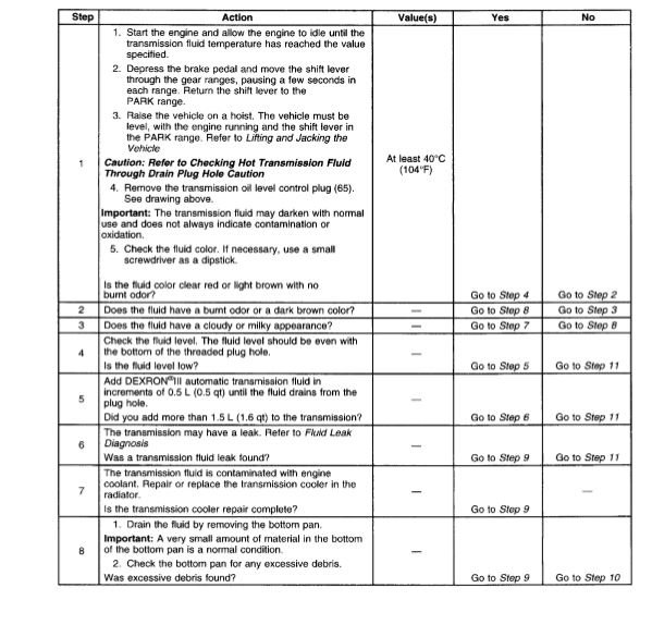

Started it this morning and it won't move.
Wednesday, June 24th, 2020 AT 11:50 AM
MECHANIC
52,797 POSTS
Good afternoon,

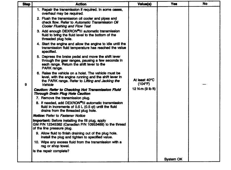

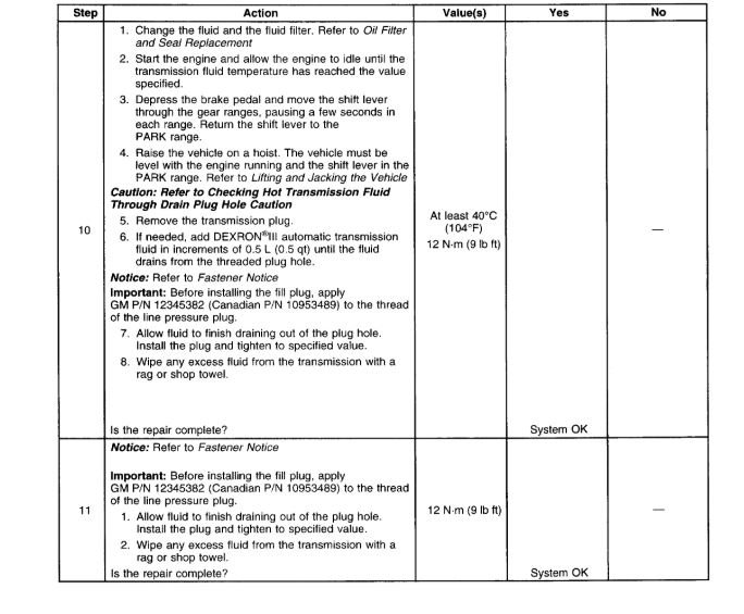

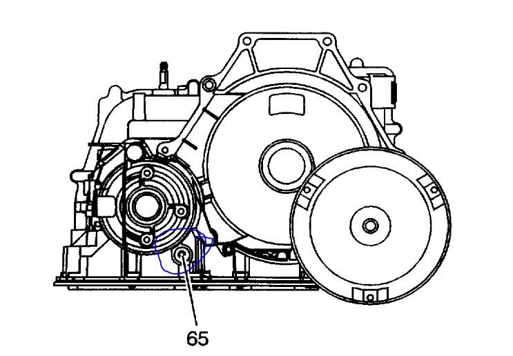

Check the fluid level first.
How long since you change the fluid and filter?
When you put it in gear, does the speedometer go up? If it does, that would indicate a broken axle shaft.
https://www.2carpros.com/articles/how-a-cv-joint-works
