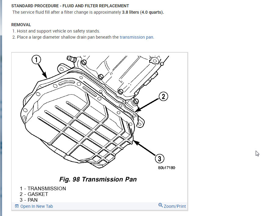

well, when i start my truck i don't here anything, but then i look down and i'm leaking transmission fluid.
May 6, 2021 at 5:28 AM

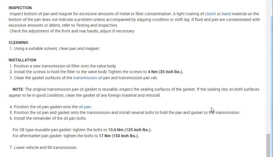

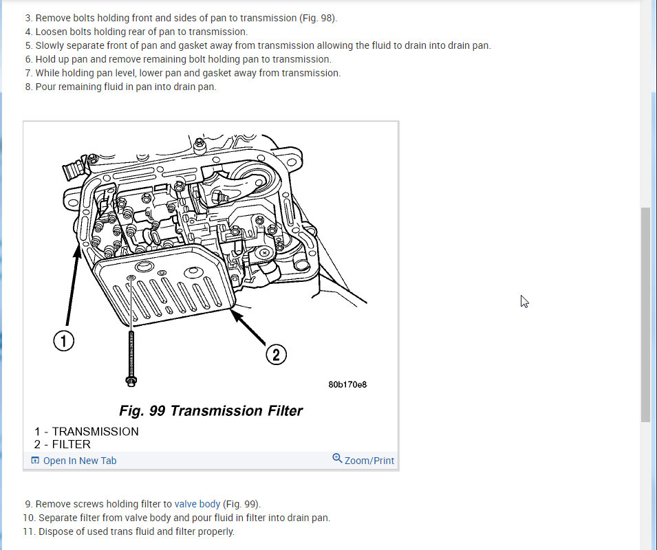

More than likely this is the pan gasket or the output shaft sea as they are the most common points of leaks. I would suggest just going ahead and servicing the transmission and if this is the pan gasket then that will fix it as well.
here is a guide that will help with this:
Below you will find the process from the manual that will help as well.
If this is not the issue then we need to get some pictures of where the leak is coming from and that will tell us where to start. Thanks
