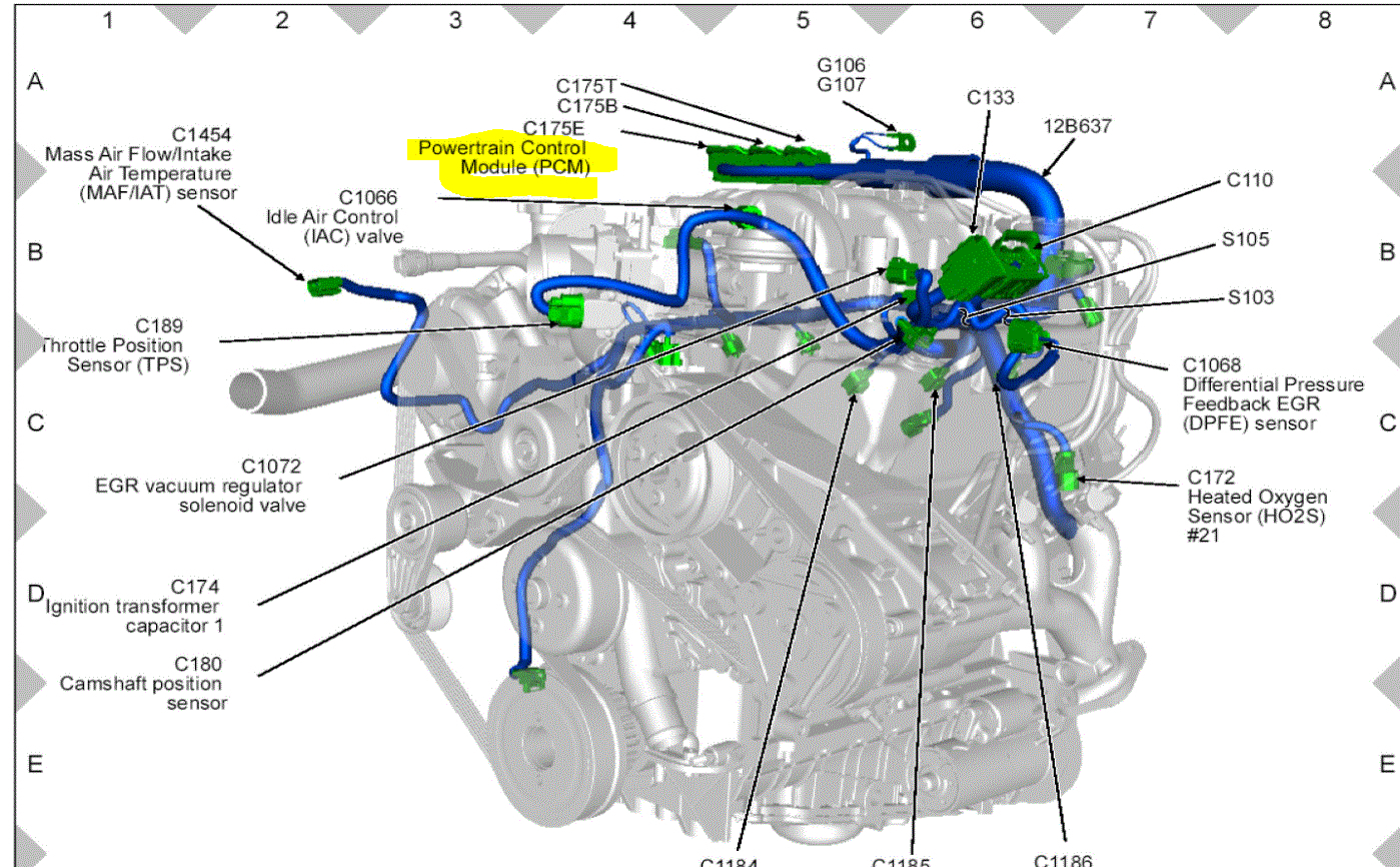

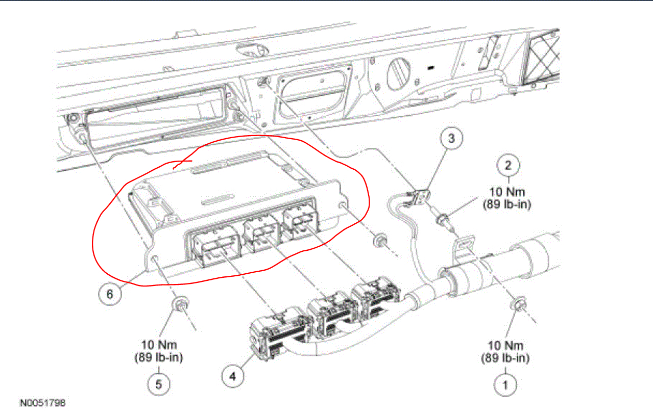

Where is the Transmisson Control Module located?
2011 FORD RANGER
150,000 MILES
STEVE DANKS
Truck listed above is a Wildtrack Transmission Control Module lost communication.
Can you tell me where this box is located on the car, please?
Mar 8, 2022 at 4:19 PM
  • 110,240 POSTS
The transmission control strategy is separate from the engine control strategy within the PCM, although some of the input signals are shared. Therefore, there is no separate TCM. The PCM controls the transmission based on multiple sensor inputs.
The PCM is behind the engine in the firewall.
Let me know if this helps.
