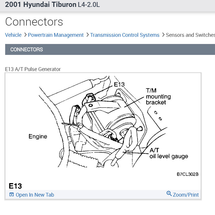

Wont shift into overdrive.
Aug 1, 2019 at 8:29 PM
Experienced Mechanic
55,732 POSTS
This happens when the turbine sensor goes out. To be sure lets run the codes to see what comes up. here is a guide with the sensor location below:
