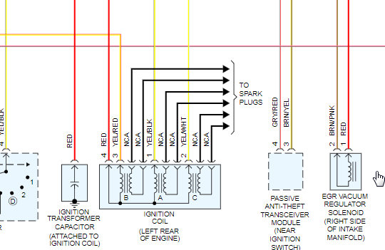

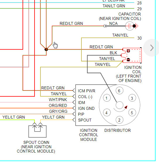

I have the car listed above it was wrecked. Transmission is in good shape.
I found a 1995 model Taurus with a 3.0 liter sohc . Same motors. Can I swap the two? It's probably a long shot but you never know until you ask.
Thanks.
Jul 4, 2020 at 2:37 AM
Unfortunately it will not. It will most likely bolt up but the electronics are very different. For starters, the 95 is a distributor ignition and the 2002 is a coil pack ignition system. This is very different and the control modules will not recognize the other. This means you will need to change over all the control systems which means this bleeds into transmission controls and other systems.
Clearly anything can be done and this could be done but most of us would not want to put the time and money into converting this to work.
Looks like you need to look for an engine out of a 1999-2005 and you should be fine. Just be careful they are not flex fuel vehicles. Those have additional sensors that yours does not have.
