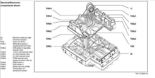

I changed out my conductor plate, shift solenoids, TCM, and transmission oil. My car is still in limp mode.

An error code popped up P0715. I cleared it then took the car on the road to reset the monitors on the scan tool. No code as of yet popped up
. Car not shifting. Checked trainee fld. good. Ran scan again no code or DTC popped up and pendinding error cleared. That's where I'm at so far. Oh but I do have a dip stick that rums down and shows the bottom tip under the valve body. Its not store bought(Mercedes dealer) I'll check more into that. So what now, Ken?

The codes you gave is a turbine speed sensor which if bad will not let the transmission shift. Here is a video that will give you an idea of what you are in for when changing the sensor. They call is an RPM sensor
https://youtu.be/f3bETtCIdxM
and diagram below for you car
