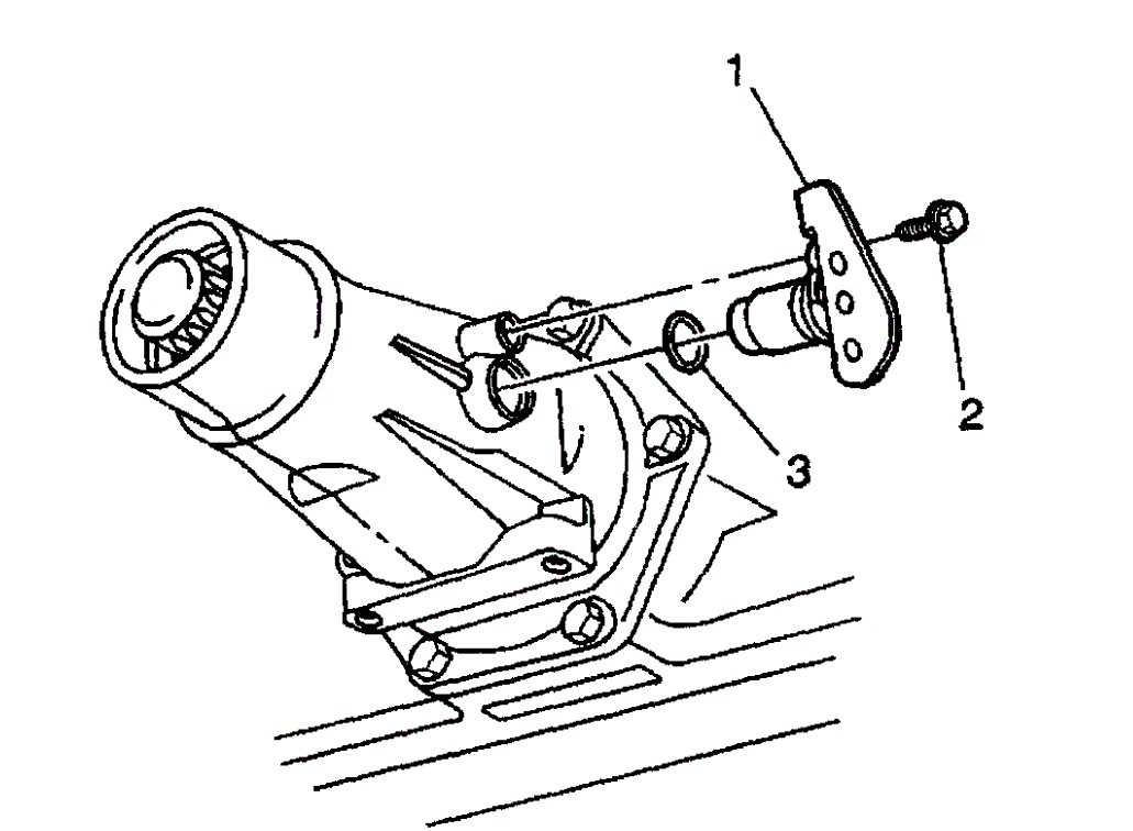

I attached a pic of the VSS. Is this the sensor that was replaced? If it was, then I need you to have the can-bus scanned to determine if there are any stored codes. CAN stands for controller area network. Basically, all computers/modules are tied together via a few wires. We need to determine if there are codes in the TCM, transmission control module.

The instrument cluster isn't working. But I put another one in, and it worked. It is a 4l60e transmission in 2003 GMC Sierra 4wd 5.3l. The transmission only holds 2nd and 4th gears. When I let off the gas, it will shift out then. I did a procedure to reset TCM. Still nothing.

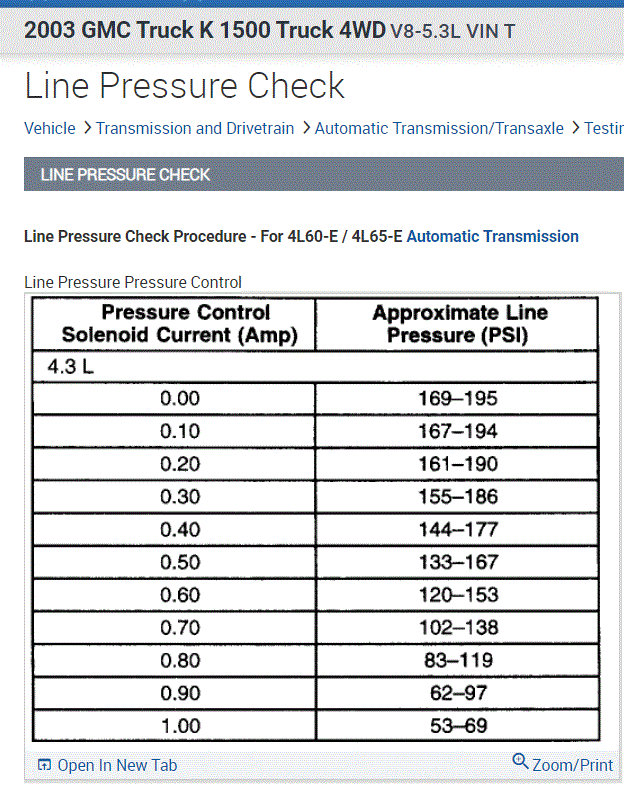

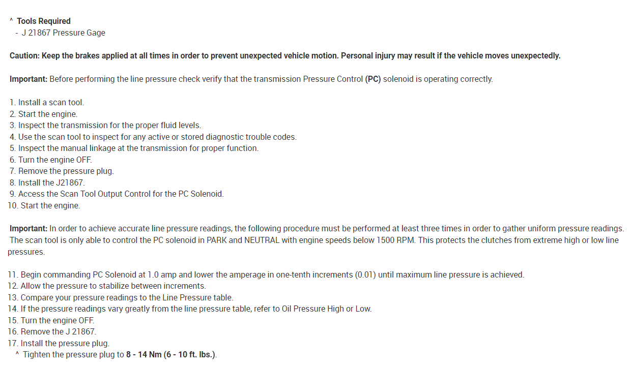

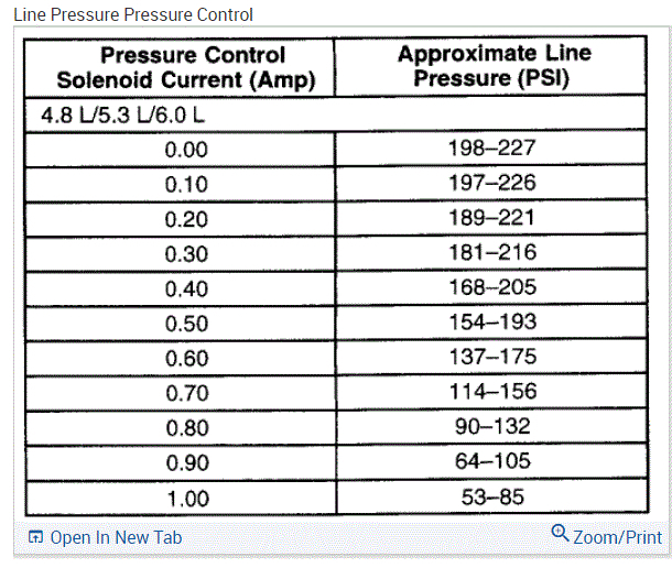

It sounds like there is a line pressure issue. When you replaced the transmission, did you install a new filter? If you did, was it securely seated in the valve body? There is an O-ring that people miss sometimes. If the old one isn't removed, it will cause a pressure issue.

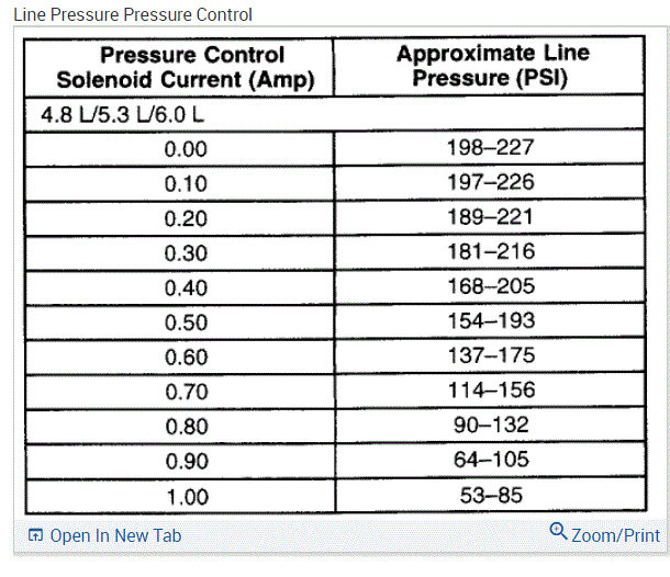

If you look below, the pics provide the directions for testing line pressure.

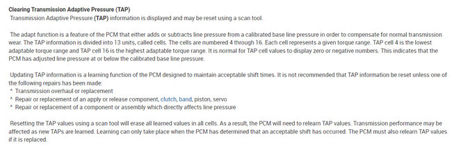

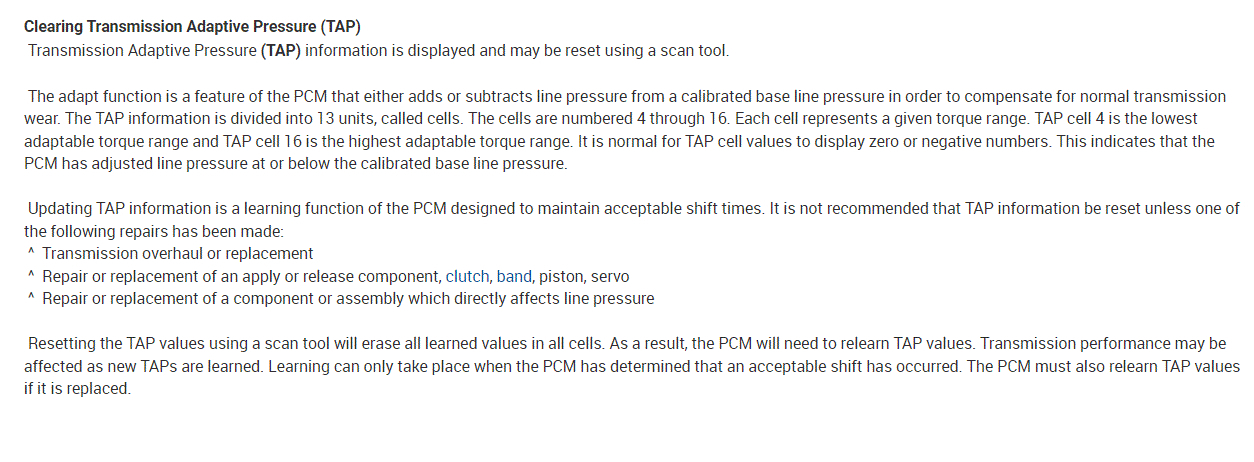

I took the rebuilt transmission back out and put another good transmission in. When I tried running it, it is still only shifting in 2nd and 4th. Do I need new speed sensors? Is there a transmission temp range sensor? Or any other sensors I should change? Or grounds I should check? Or if I change PCM, TCM, computers out and gear box and flash them, would that make it right?
Oct 2, 2021 at 12:30 PM
  • 110,248 POSTS

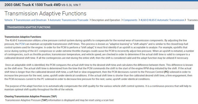

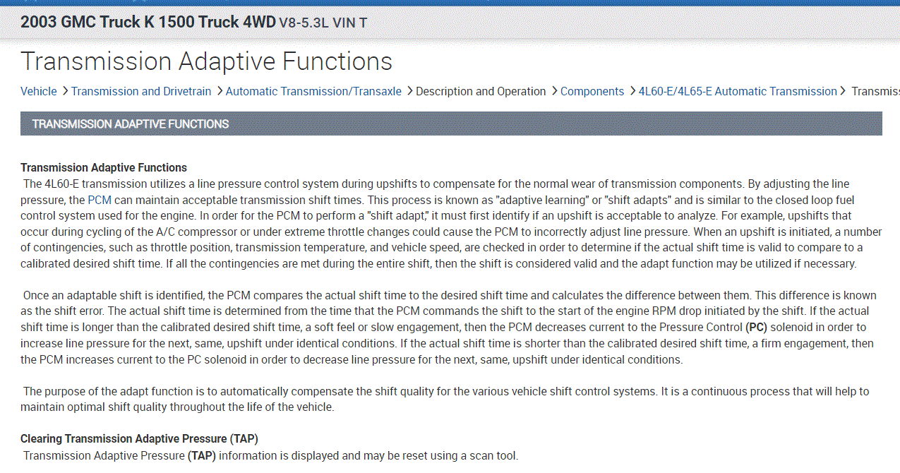

If it is doing the same thing with a different transmission, it is likely related to the TCM or the transmission adaptive pressure functions (TAP).

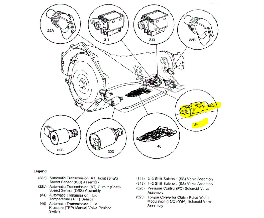

First, pic 1 below shows the trans fluid temperature sensor. It is internal.
You mentioned the speed sensors. Is the speedo working properly? Are the sensors in this transmission from the old one? If not, I don't think that's the issue. Plus, if it were a speed sensor, it would cause all gear shifts to be off and not only use 2 and 4.

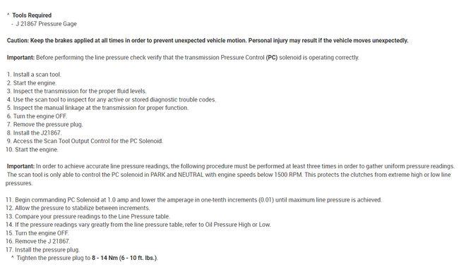

Pics 2 and 3 are the procedure for the adaptive relearn. It does require a scan tool that can communicate with the TCM.
