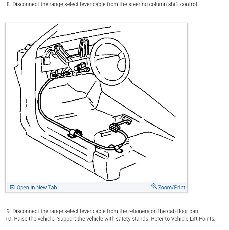

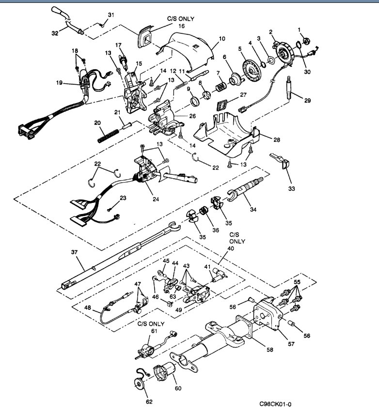

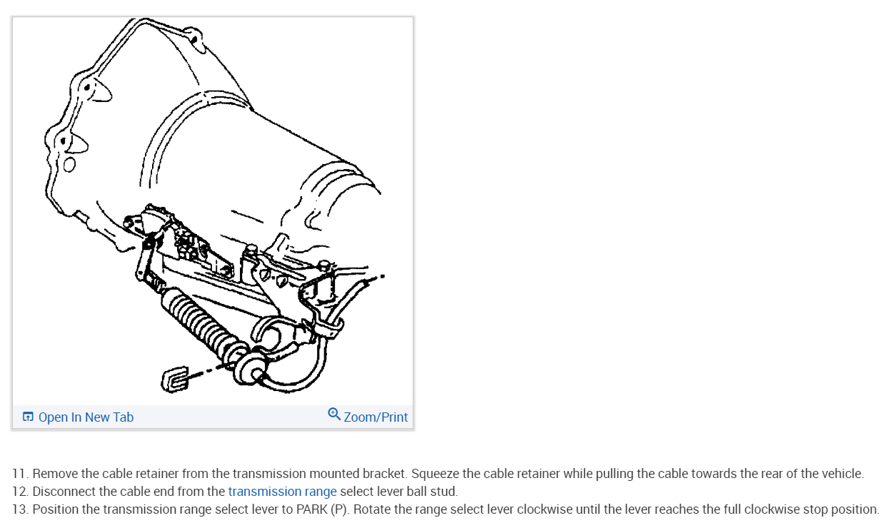

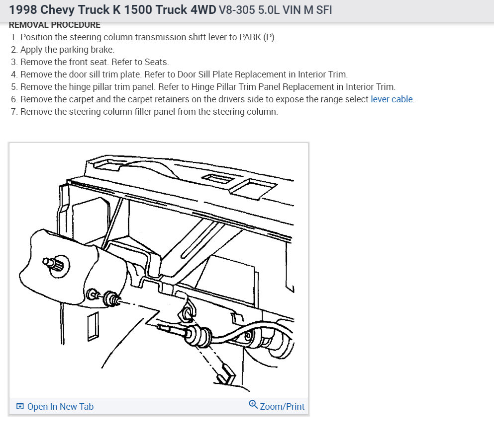

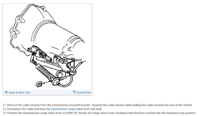

It sounds like you have a problem with the shift cable or interlock solenoid. here are diagrams for you to check out to fix the problem. Check out the diagrams (below). Please let us know what you find. We are interested to see what it is.
