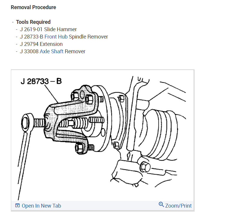

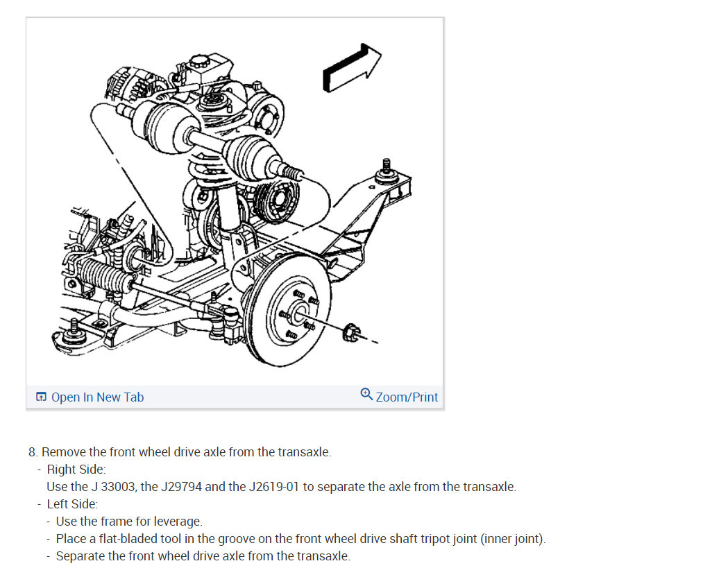

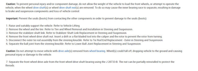

I would check the axle shafts first to be sure neither one is broken. It can cause this issue.
https://www.2carpros.com/articles/replace-cv-axle
If the axles are good, then the transmission itself is the issue. It will have to be replaced.
