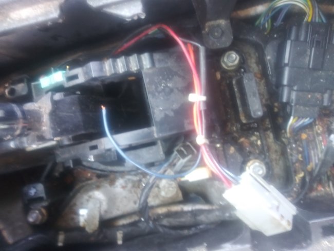

Driving the road going 35 MPH and in an instant car down shifted to a lower gear. Speedometer dropped from 35 to nothing. Coasted another 500 yards to a parking lot gas station tried to accelerate 20 feet from the gas pump. Car was struggling to make the last ten yards. After fueling , turned the key over with no start. There were some relays that were clicking but no start and no turn over. Got a friend to tow the car and as I tried to put it in neutral, Shifter was stuck. Disassembled trim around console and shifter to put it into neutral
Performed scanner and no DTC's. Cleared the codes anyway , disconnected negative battery cable for two hours and still no crank. I noticed a loose blue wire around the shifter but can't seem to unlock the connector where the loose wire is. Four terminal grey connector, orange red, black, and the blue wire is broke loose.

Just to be clear, that wiring is around the shifter? Do you see where the connector is supposed to go?
However, was this an issue prior to it not starting? Meaning you found this after it shut off and did not start? If that is the cause I doubt this is the cause of your no start.

Hello KASEKENNY1 Sorry for the late reply. I have my plate full of automobile woes along with life gets in the personal issues type stuff. To answer your questions in order, yes, the photo I took was the shifter from the car listed above. The reason I took the photo is because the key-way slot right next to the shifter on the upper right of the shifter would not unlock it out of park. So i started disassembling at the gas station before I was ready before my friend showed up to tow the car back to my house. Second question; No. I couldn't see where the wiring was coming from because the four wires that wraps around the shifter came out of a four terminal grey connector just left of the shifter control that is the part of the main console harness that branches off, ( if you will), And I'm assuming that harness came from the smart jct. box.

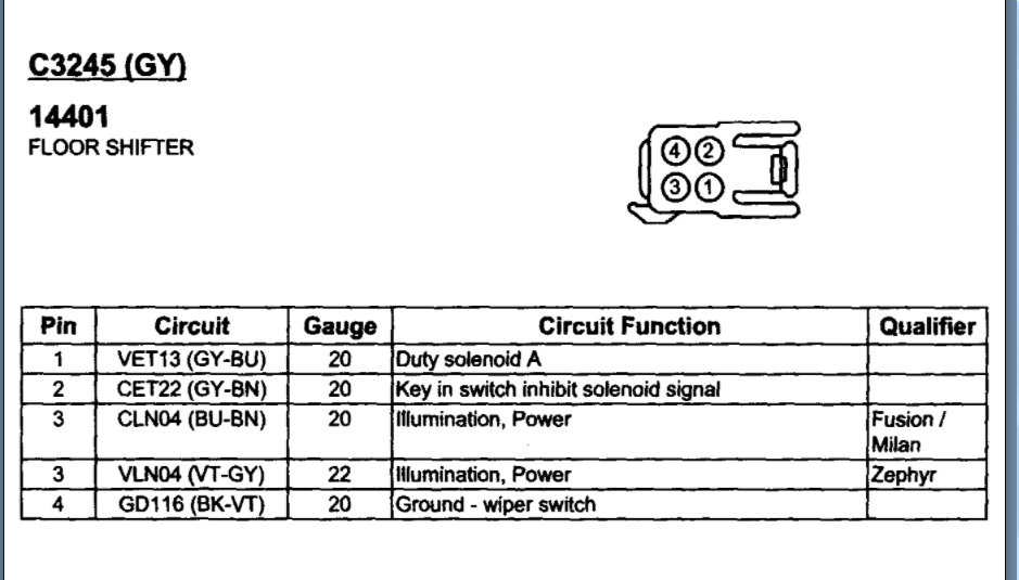

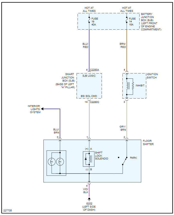

Okay. Let's start with the connector and get those wires squared away and then we can work our way through this. If you want to go ahead and check fuel pressure then you can do that. Here is a guide that will help with that:
You will find the connector view for this connector so we can get them in the correct places. Plus the wiring diagram for this connector.
Let us know what happens when the wires are back in place and then what the fuel pressure is and we can take the next steps. Thanks

Hey Kasekenny . Again, sorry for not getting back with you. The wires was for the interior light for the shifter . The blue wire was pull out of the bulb itself and the black was for the ground on the bulb that illuminates the shifter bulb. For all intense purposes I performed a gas pressure test and the results was 42 psi.
