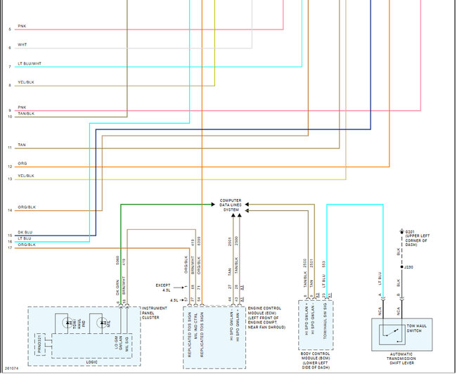

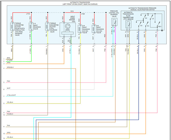

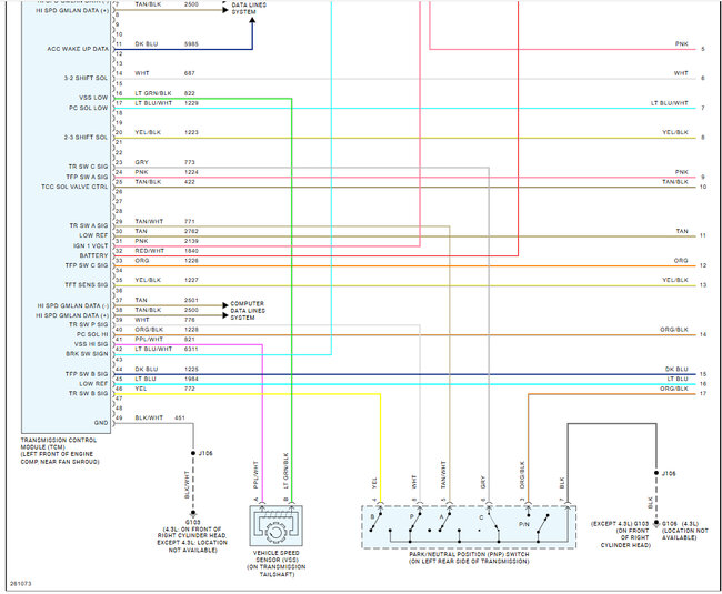

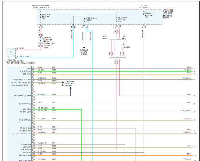

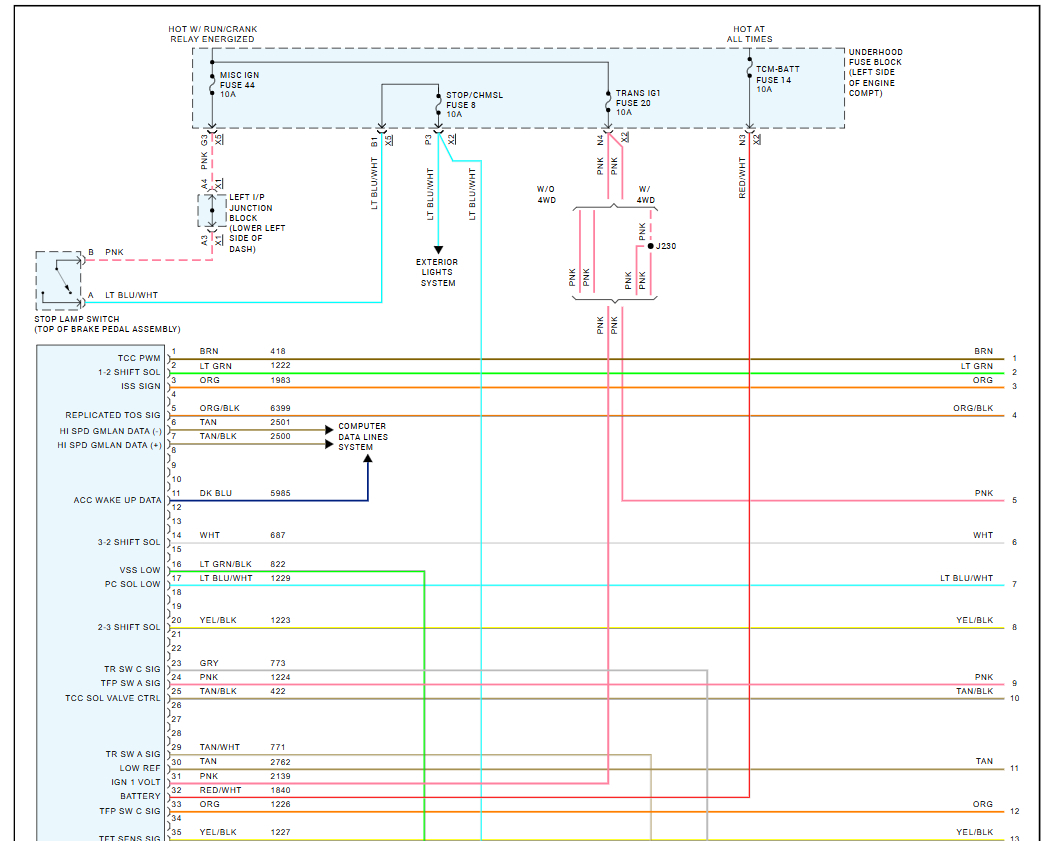

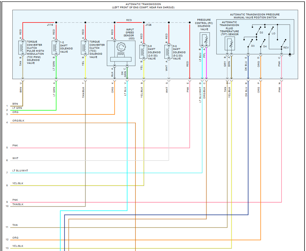

I need a picture of 4l60e transmission wires and connectors plugged into truck after a reinstall. Want to make sure I have them all plugged in correct. The speed sensor, oxygen sensors and other plugs.
Feb 18, 2025 at 10:57 AM
  • 55,433 POSTS
Sure, here is a guide to help you with the testing and the transmission wiring diagrams in the images below.
Check out the images (below). Let us know if you need anything else.

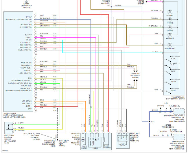

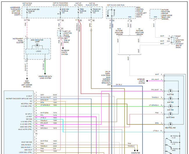

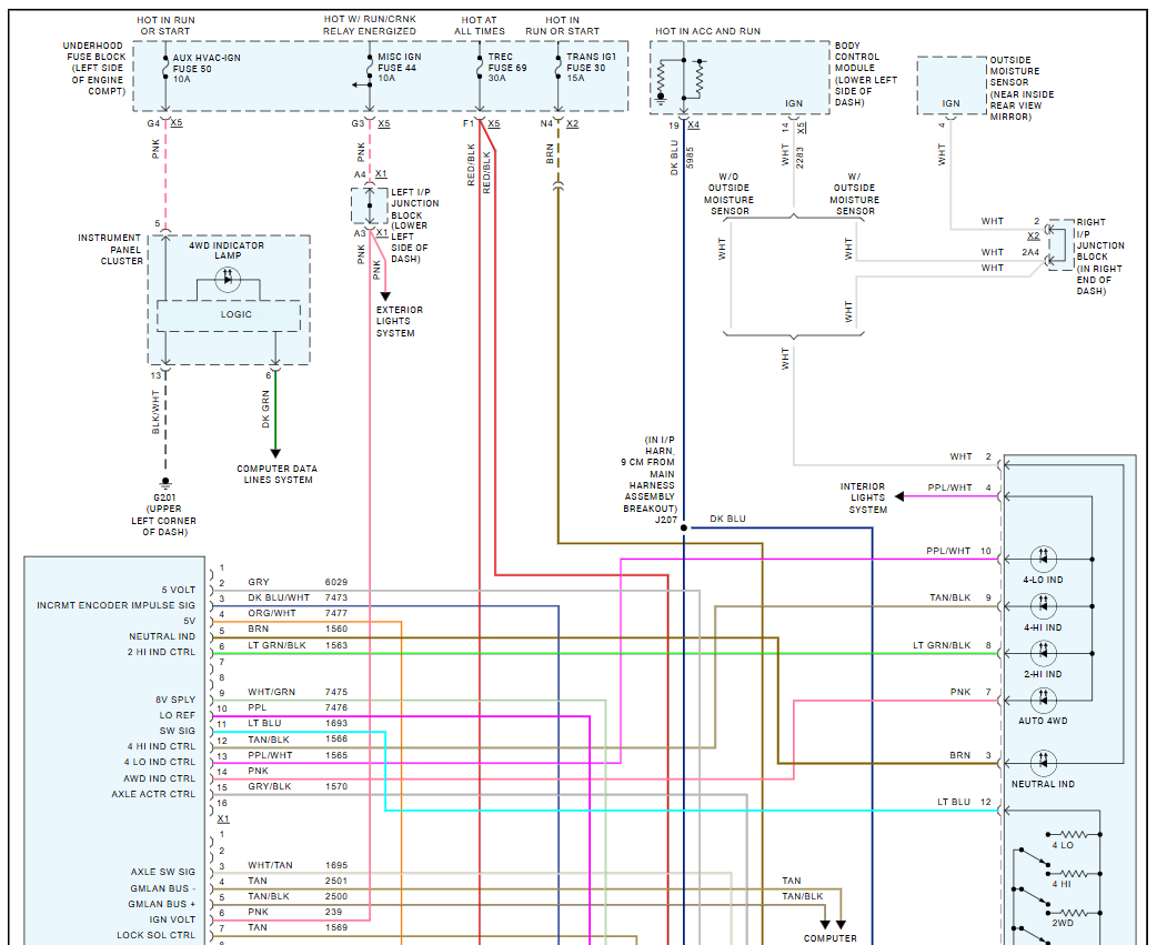

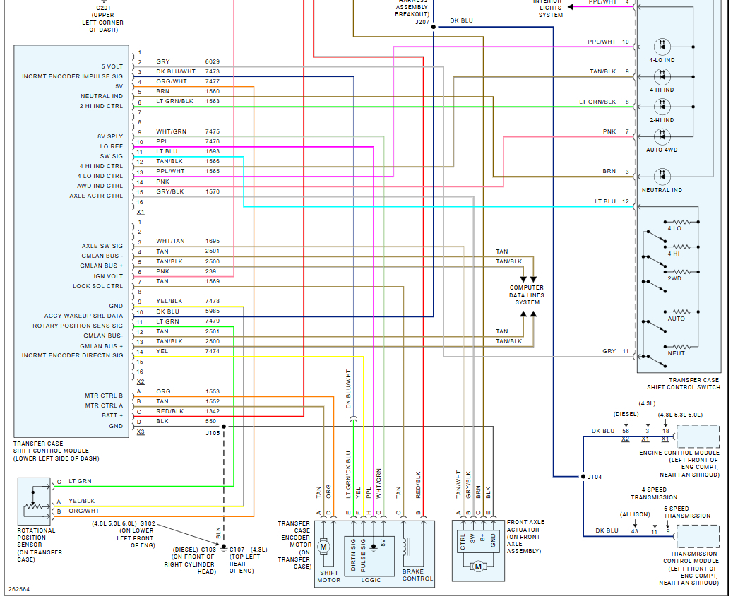

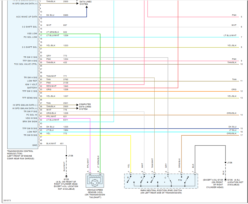

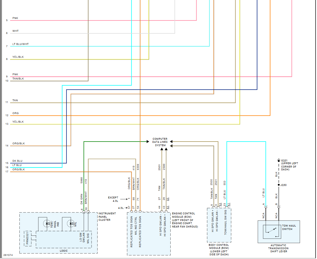

Can I get pictures of where each wire runs to VSS and other sensors on transfer case and transmission from the main harness?
Feb 19, 2025 at 1:15 PM
  • 55,433 POSTS
Did you see the wiring diagrams above? It shows the VSS wiring diagrams. Here is the wiring for the transferase. Check out the images (below). Let us know if you need anything else.
