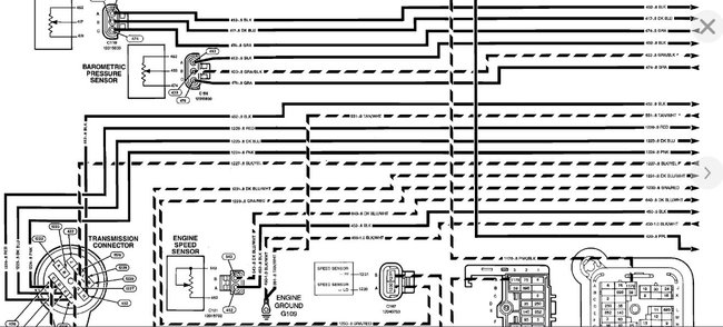

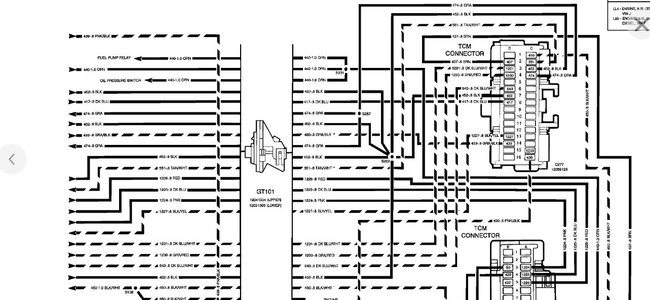

Looking for a transmission wiring harness diagram. I was pulling the transmission and ripped a wire from a not so great wire repair job. So I need to find the wiring diagram for the transmission so I can make the proper repair. Any help would be greatly appreciated!!

I attached diagrams of the transmission for you to view.

That is exactly what I needed! Thank you very much!! Now I know where I have to go with the wires. Thinking about rewiring the harness.
