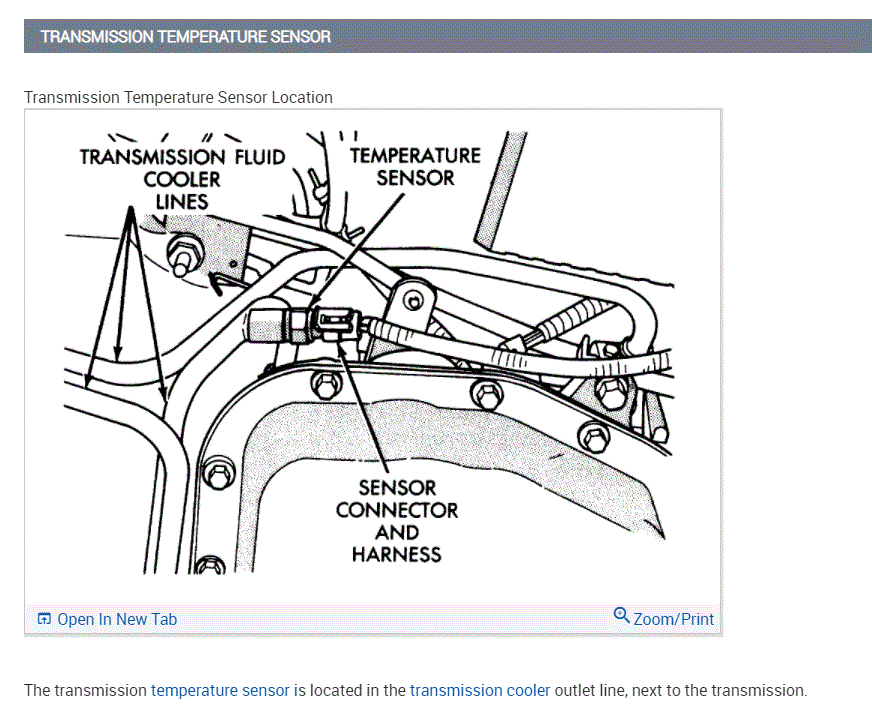

The two are likely tied together. Code 24 indicates an open or high voltage to the TPS Partial throttle. Code 37 is related to the TCC unlock solenoid an open or shorted condition is detected in the torque converter part throttle unlock solenoid circuit which ties into either a transmission temp sensor having high or low voltage.
I need to start with the TPS. Why is it disconnected? Also, I need you to check the temperature sensor on the trans to make sure the wiring to it isn't damaged, the connector is clean and tight, and there is no damage to the sensor.
I attached a pic of the sensor below for you to see. Also, since the TPS is disconnected, it may be causing an issue within the PCM preventing proper voltages to the temperature sensor and the TCC solenoid.
Let me know what you find.
See pic below.
