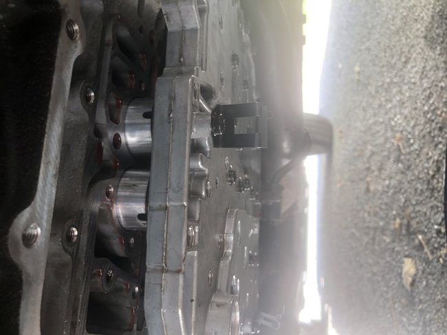

I have followed everything I can find on removing the valve body so I can replace the shift solenoid. I’ve got it dropped but won’t come all the way out. Seems like something is stopping it but can’t find anything. Cable is already disconnected and all screws out. Won’t drop any further than shown in image.

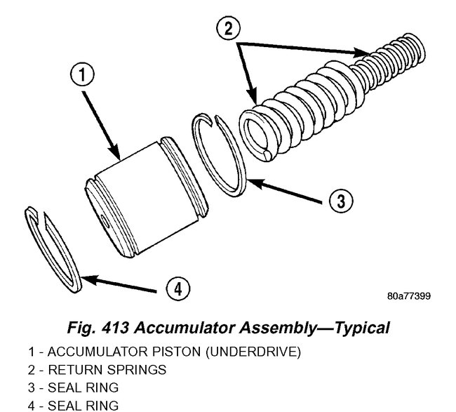

First, here are the directions right from Alldata for removal. I want you to have them because towards the end of the directions, it explains how the accumulator springs can come out. Also, it will give you a chance to see if anything was missed. Note that there is a specific position that the shift lever needs shifted one point past low. That may be what is holding it in place.

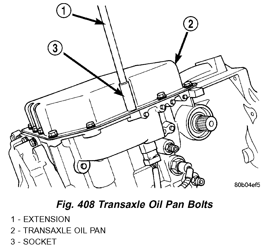

4. Remove transaxle pan bolts (Fig. 408).
Pic 2

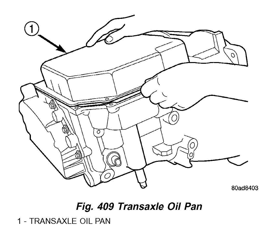

5. Remove transaxle oil pan (Fig. 409). When reinstalling oil pan be sure that pan flange is clean and oil free. Apply a 1/8 inch bead of Mopar Silicone Sealer onto oil pan flange before installing.

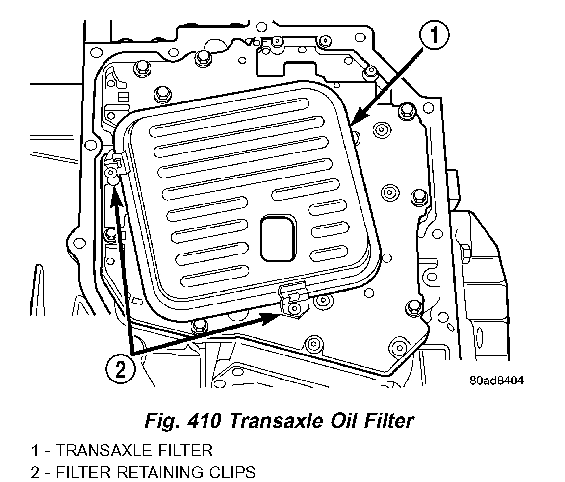

6. Remove oil filter from valve body (Fig. 410). It is held in place by two clips.
CAUTION: The 42LE transaxle oil filter is not interchangeable with the 41TE transaxle filter. Installation of a 41TE oil filter in a 42LE may cause transaxle damage.

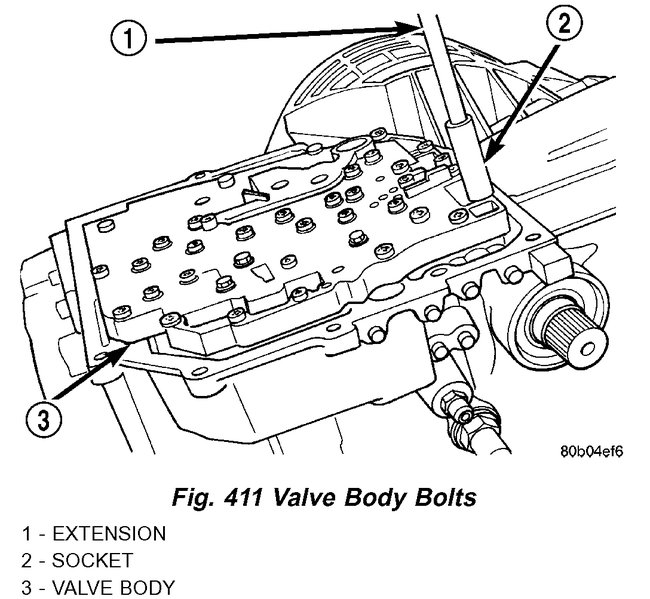

7. Remove valve body bolts-to-case (Fig. 411).

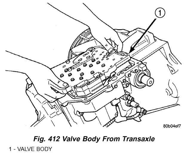

8. Carefully remove valve body assembly from transaxle (Fig. 412). (Fig. 415)
pic 7
pic 8

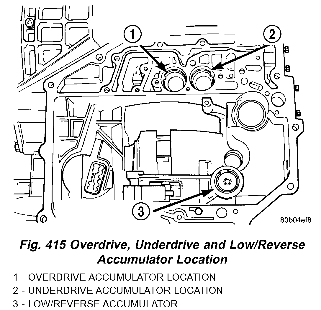

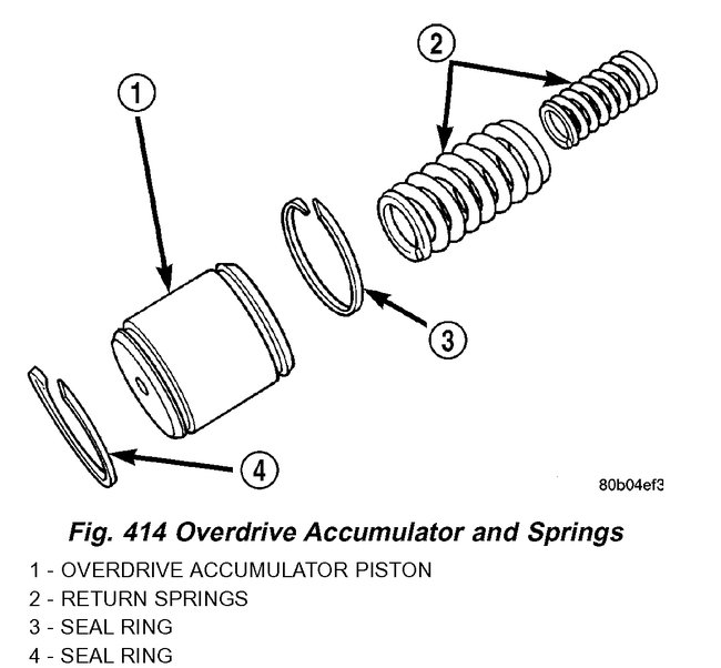

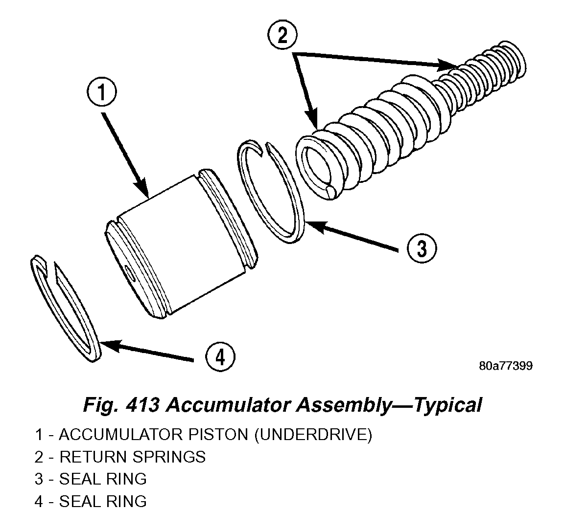

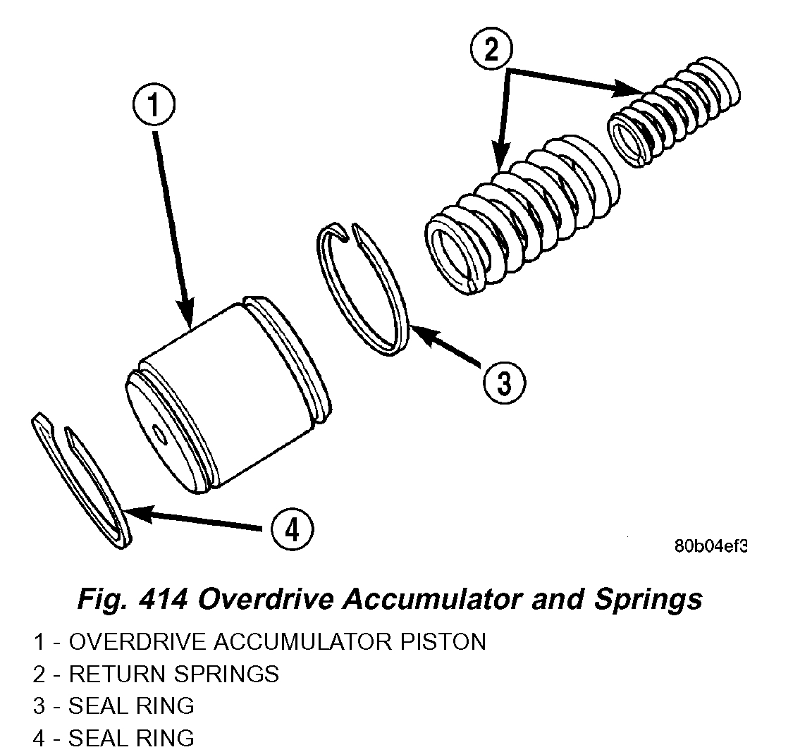

CAUTION: The overdrive and underdrive accumulators and springs may fall out when removing the valve body (Fig. 413) (Fig. 414) (Fig. 415).

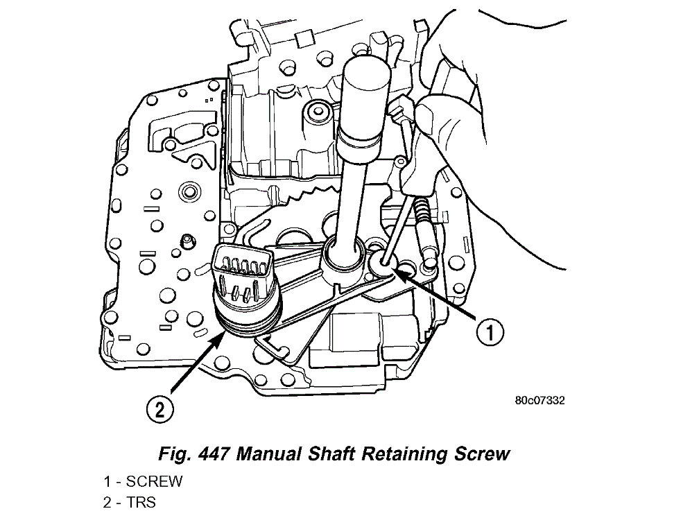

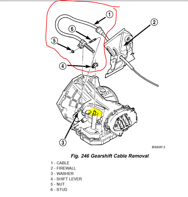

Thank you for the information as it does help and I have marked the overdrive and under-drive accumulators. So I know where they go. My issue is I cannot find the shift lever/cable.
Wednesday, July 15th, 2020 AT 4:48 PM
  • 109,885 POSTS
I thought that was off. That is what is holding the valve body in. That needs removed or the shift lever can't drop down and out. I attached a pic. Let me know if that is what you are referring to.
Wednesday, July 15th, 2020 AT 7:05 PM
REDROSE43311
  • 8 POSTS
Good morning Joe. Yes, I do have that off, but what part do I turn? I have tried the rod it connects too and it will not turn. Thank you for all your help!

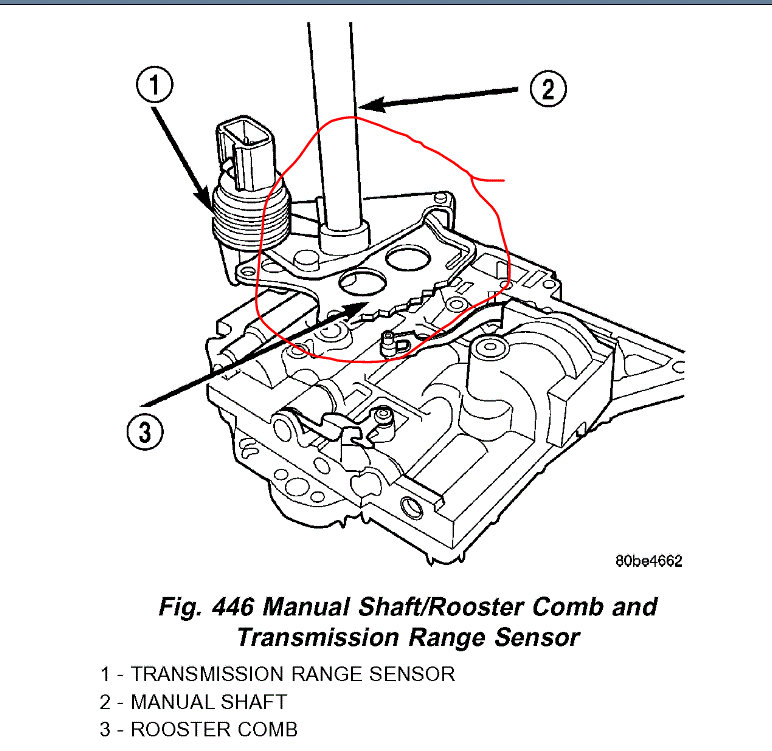

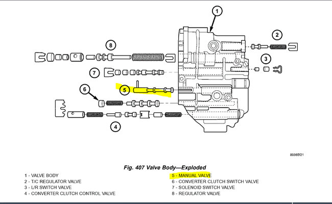

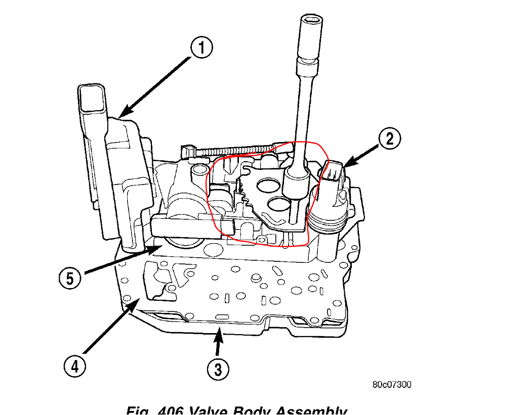

If it doesn't turn at the transmission with it disconnected, I suspect the manual valve or shaft which attaches to the shift cable were not properly installed. The manual shift valve is operated via the cable through the shift lever shaft. When you installed them, do you remember having any trouble? Were you able to turn the shift shaft prior to reinstalling the valve body?
See the attached two pics.
PS: I don't know if you already looked at my reply, but I found two better pics for you. Pic 3 is what is called the "rooster comb" and pic 4 shows it's retainer. Did you install the retainer screw?
Thursday, July 16th, 2020 AT 8:36 PM
REDROSE43311
  • 8 POSTS
Woo hoo, I got it all back together. It was that little rocker like arm not going into place. But, the reason I did all this was to replace the Solenoid Pack because my car wouldn’t go out of second gear. Bought a new one and it’s all installed, full of fluid. Still won’t go out of second. :( Any ideas?
