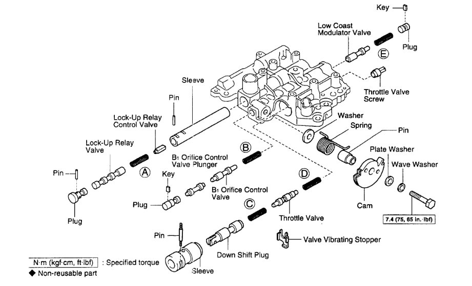

Transmission valve body valve lines?
1997 TOYOTA AVALON
200,000 MILES • 2.3L • 6 CYL • 2WD • AUTOMATIC
RAYMOND NIMMO II
I need to know where all the little tubes go connected on the valve body. I can't figure it out.
Sep 2, 2022 at 1:58 PM
  • 110,194 POSTS

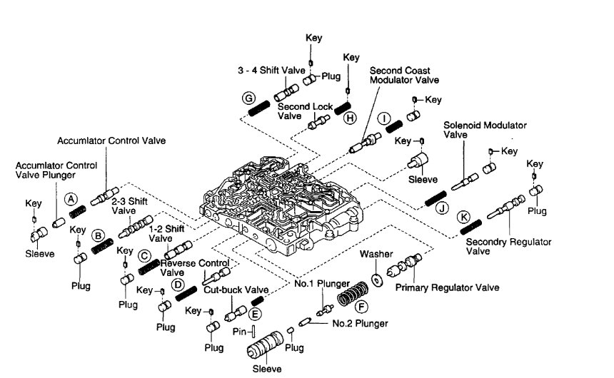

I'm not sure what you are referring to when you say tubes. So, I have attached two pics below. Pic 1 is an exploded view of the upper valve body. Pic 2 is an exploded view of the lower valve body.
Take a look through them and see if you can identify the components you need.
