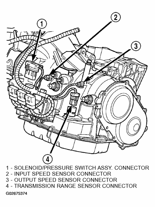

OBXAUTOMEDIC
  • 3,711 POSTS
This means you need to replaced the transmission input shaft speed sensor. Here is a video of the job being done so you can see what you are in for when doing the job.
https://youtu.be/f3bETtCIdxM
Here is the location for your car.
Cheers
Jul 6, 2020 at 6:55 AM (Merged)

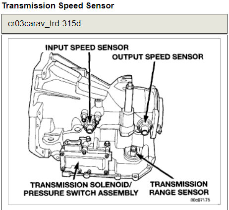

SHANEDCAT
my 2003 dodge caravan has the obd2 code p0725 come up speed input sensor parts store say they only have one sensor but manuel says there are 2 are they the same
CARADIODOC
  • 34,381 POSTS
Yup, there's two and they are different. Input speed sensor and output speed sensor. They refer to engine speed and axle shaft speed.
BMRFIXIT
  • 19,053 POSTS
check the picture

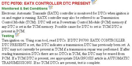

ZACKMAN
  • 4,202 POSTS
Any particular reason why you replaced the CKP sensor, when both the codes refers to the transmission?
P0700 Transmission Control System Circuit. Your transmission control module.
P0725 Engine Speed Input Circuit Error. Possible from P0700 and/or input speed sensor.
Jul 6, 2020 at 6:56 AM (Merged)

ZACKMAN
  • 4,202 POSTS
Try this diagnostic.
https://images.2carpros.com/forum/automotive_pictures/55316_02caravanp0700_1.jpg
DTC P0725: ENGINE SPEED SENSOR CIRCUIT NOTE: Crankshaft position (CKP) sensor signal may also be know as EATX RPM signal. NOTE: Ensure PRE-DIAGNOSTIC CHECK has been performed before proceeding with the following procedure. Circuit Description DTC P0725 will set when engine speed is less than 390 RPM or greater than 8000 RPM for more than 2 seconds with engine running. Possible Cause  Open crankshaft position sensor signal circuit.  Crankshaft position sensor signal circuit shorted to ground.  Crankshaft position sensor signal circuit shorted to voltage.  Malfunctioning TCM.  Malfunctioning PCM. Diagnostic Procedure 1. Using scan tool, read PCM DTCs. See appropriate SELF-DIAGNOSTICS article in ENGINE PERFORMANCE. If any crankshaft position sensor DTCs are present, diagnose and repair fault before proceeding. If no crankshaft position sensor DTCs are present, go to next step. 2. Using scan tool, check STARTS SINCE SET counter. If counter is not set to zero, go to step 8. If counter is set to zero, go to next step. 3. Turn ignition off. Disconnect TCM and PCM harness connectors. Measure resistance of crankshaft position sensor signal circuit between TCM and PCM harness connectors. See WIRING DIAGRAMS. If resistance is less than 5 ohms, go to next step. If resistance is not less than 5 ohms, repair open in crankshaft position sensor signal circuit. 4. Measure resistance between ground and terminal No. 6 (crankshaft position sensor signal circuit) at TCM harness connector. If resistance is less than 5 ohms, repair crankshaft position sensor signal circuit for short to ground. If resistance is not less than 5 ohms, go to next step. 5. Connect TCM harness connector. Ensure PCM harness connector is disconnected. Turn ignition on. Measure voltage between ground and crankshaft position sensor signal terminal at appropriate PCM harness connector. See WIRING DIAGRAMS. If voltage is 10 volts or less, go to next step. If voltage is greater than 10 volts, repair crankshaft position sensor signal circuit for short to voltage. 6. Measure voltage between PCM harness connector ground and crankshaft position sensor signal terminals. Ensure ignition is on. If voltage is 4.5-5.5 volts, replace PCM. See appropriate REMOVAL, OVERHAUL & INSTALLATION article in ENGINE PERFORMANCE. If voltage is not 4.5-5.5 volts, go to next step. 7. If not problems have been found, replace TCM. See TRANSMISSION CONTROL MODULE under REMOVAL & INSTALLATION. Perform SHIFT QUALITY QUICK-LEARN PROCEDURE and PINION FACTOR PROCEDURE under PROGRAMMING. 8. Conditions needed to set DTC P0725 are currently not present. Perform wiggle test to diagnose intermittent or poor connections. Repair as needed. If no problems are found, testing is complete.
