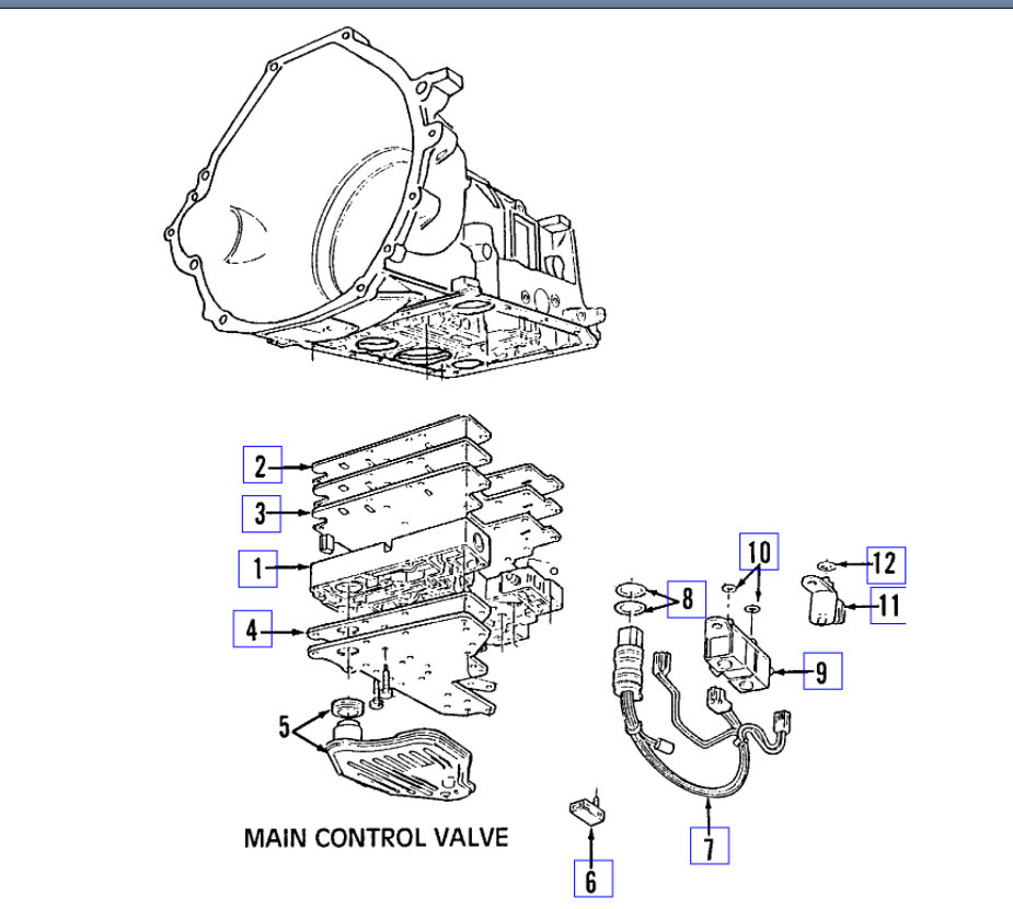

Good afternoon,
This sounds like a valve body issue. I would drop the valve body and clean it. You will have to remove all the valves and use a good cleaner to get rid of all the dirt and debris in the passages.
I attached a picture for you of the valve body. Make sure all the gaskets are installed and not damaged.

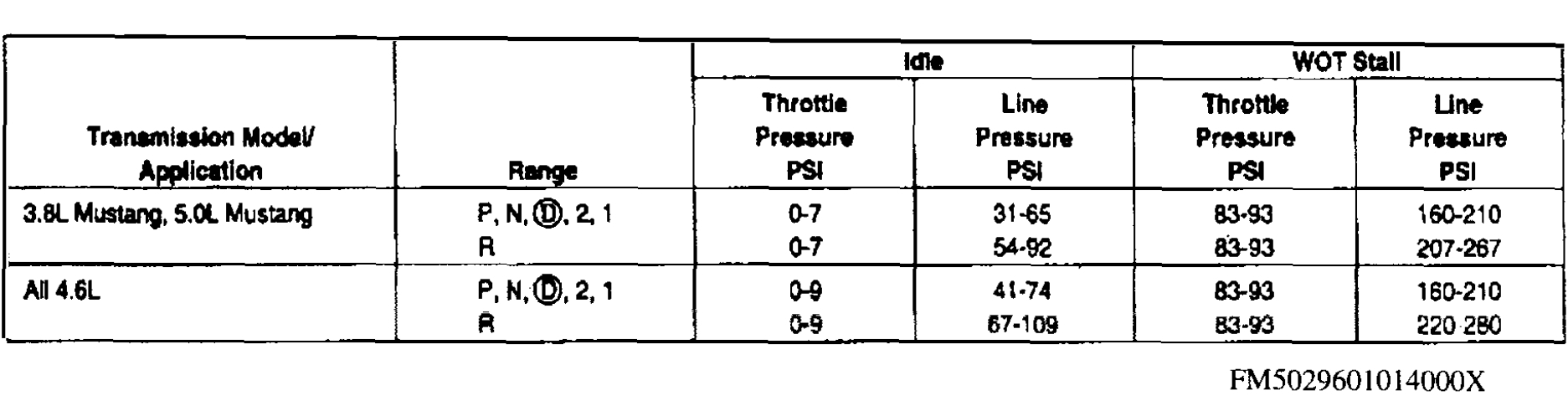

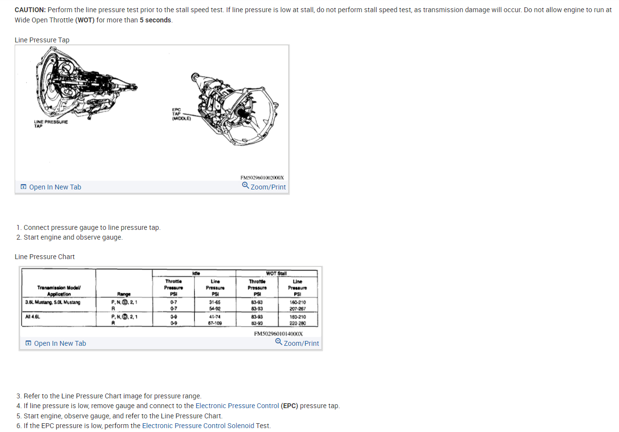

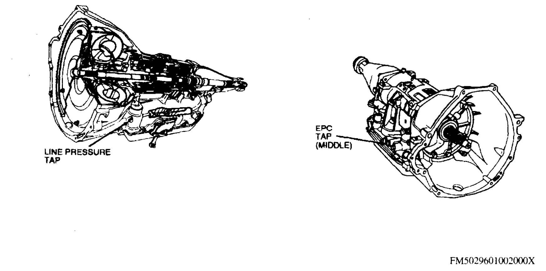

Was there any debris in the old valve body?
I would check the line pressure. I attached the procedure and the pressures needed for you below. Let us see if the pump is providing the correct pressure.
