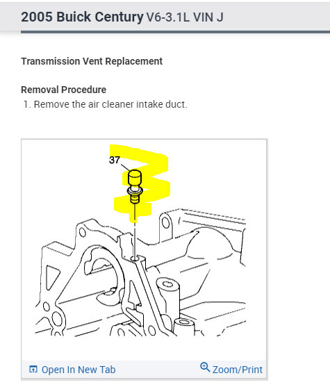

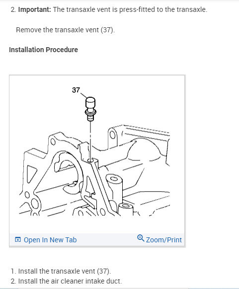

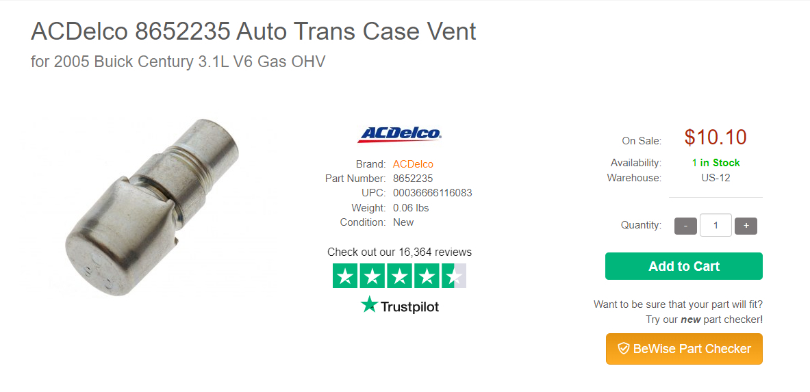

If the transmission isn't over full, then suspect the transmission breather is likely clogged. If you take a look below, I provided the directions for replacing the vent. If you decide to do this, I attached a pic below (pic 3) which I believe is the one you need for your vehicle. It includes the OEM part number.
