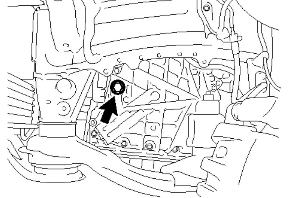

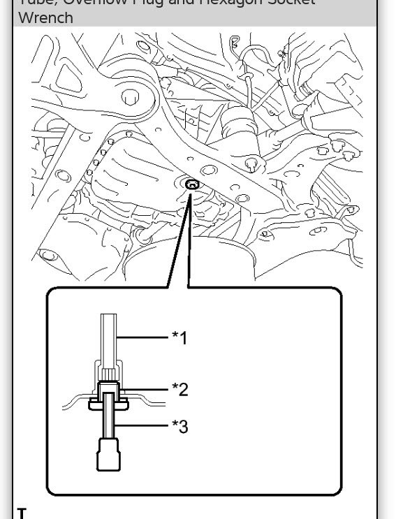

I would like to learn how to replace the automatic transmission fluid. Step by step. This car does not have dipstick tube and the ATF must be replaced every 60,000 miles. I would appreciate it if you can get a video. Thank you very much for your cooperation. The Lord bless you.

see attached article this may or may not be the same as yours. also this must be done with car level to fill transmission. see picture for fill hole. you do not need to pull pan on this transmission there is a drain and measure amount drained out. there are two different transmissions on this car so this may not be correct as we do not know what you have.
