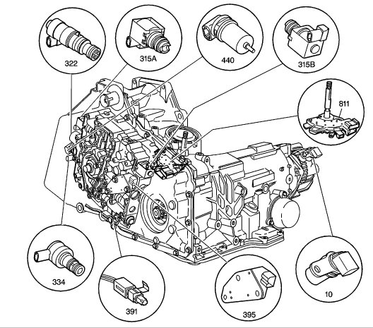

I am looking for a diagram with the location of the transmission temperature sensor on my vehicle? The sensor became unhooked while replacing pressure switch and I do not see where the TTP is suppose to be. Any help would be much appreciated.

The transmission fluid temperature sensor is under the side cover.
Here is a diagram (below) of its location:

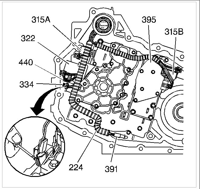

Remove the case side cover.
Remove the wiring harness assembly from the fluid temperature sensor (391).
Remove the fluid temperature sensor (391).

Cannot find the sensor, is it inside or outside the transmission?

Inside the transmission valve body cover at the bottom of the case, below the valve body. #391 Check out the diagrams (Below). Please let us know if you need anything else to get the problem fixed.
