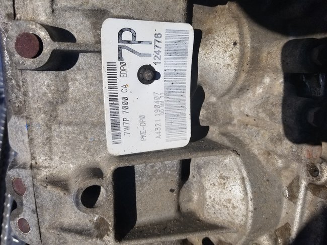

I have a 2007 Ford Crown Victoria police interceptor transmission, it's going into a 2004 F150. Will I need a shorter driveshaft?

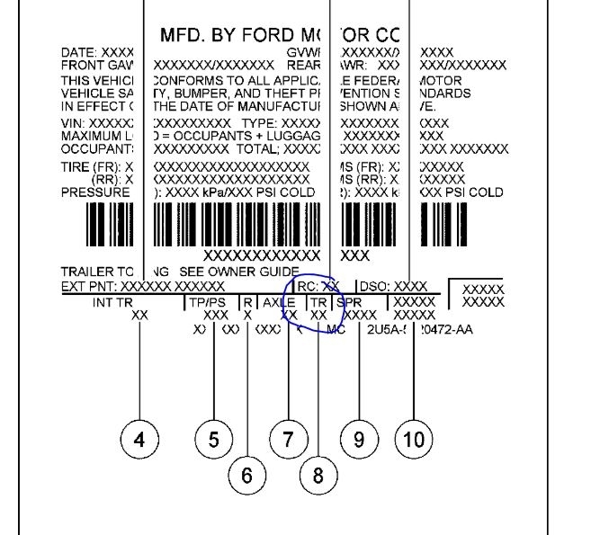

I attached a image of the label on the drivers door.
Can you give me the 2 letter code for the transmission?
Mar 24, 2021 at 6:37 AM
CHEFCOREYWRIGHT
  • 9 POSTS
The transmission going in is RFF3UP7A040AA.

Hey Roy, is there a reason the transmission seems twisted and bolts have to be forced into the motor?
Can you post a picture of what you see?
CHEFCOREYWRIGHT
  • 9 POSTS
Okay, so basically we got the torque converter bolts on and then the transmission bolts were not lining up on the one side. it seems like the transmission twisted there because there's too much pressure on the bolts.
