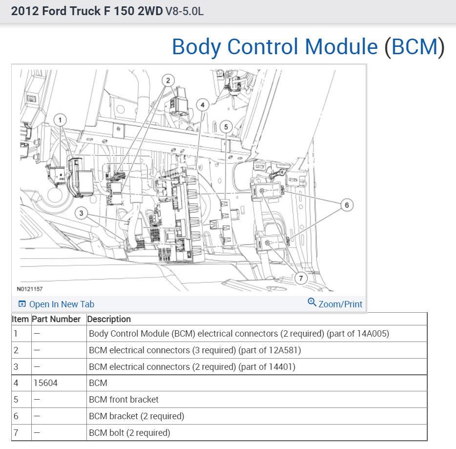

Took off this morning and the truck wouldn't shift out of first gear. RPMs went to about 3500. I took my foot of gas and RPMs jumped up a little and came back down slowly, but still would not shift out of first gear. Noticed speedometer not working. After about a minute it started working again and worked fine. It did the same thing after work.
Does this sound like throttle positions sensor, or speed sensor, or something else?
Jun 27, 2022 at 9:37 AM
  • 55,808 POSTS

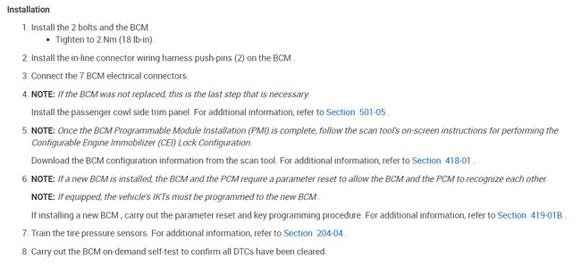

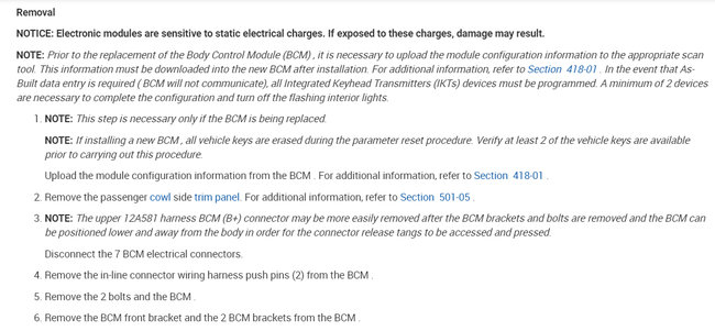

The speedometer and transmission depend on the speed input from the ABS and body control modules. To find out which one is bad let's do a CAN scan which is the future of automotive repair. You can get a CAN scanner from Amazon for about $30.00. here is a video to show you how and a link to a scanner from Amazon. I have included how to change out the BCM, which is what I think is bad.

F150ECOBOOST
It was the transmission speed sensor, or lead frame sensor in this particular transmission. $1,000. fix.
