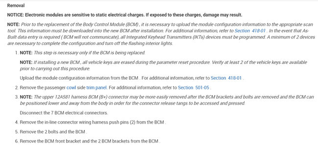

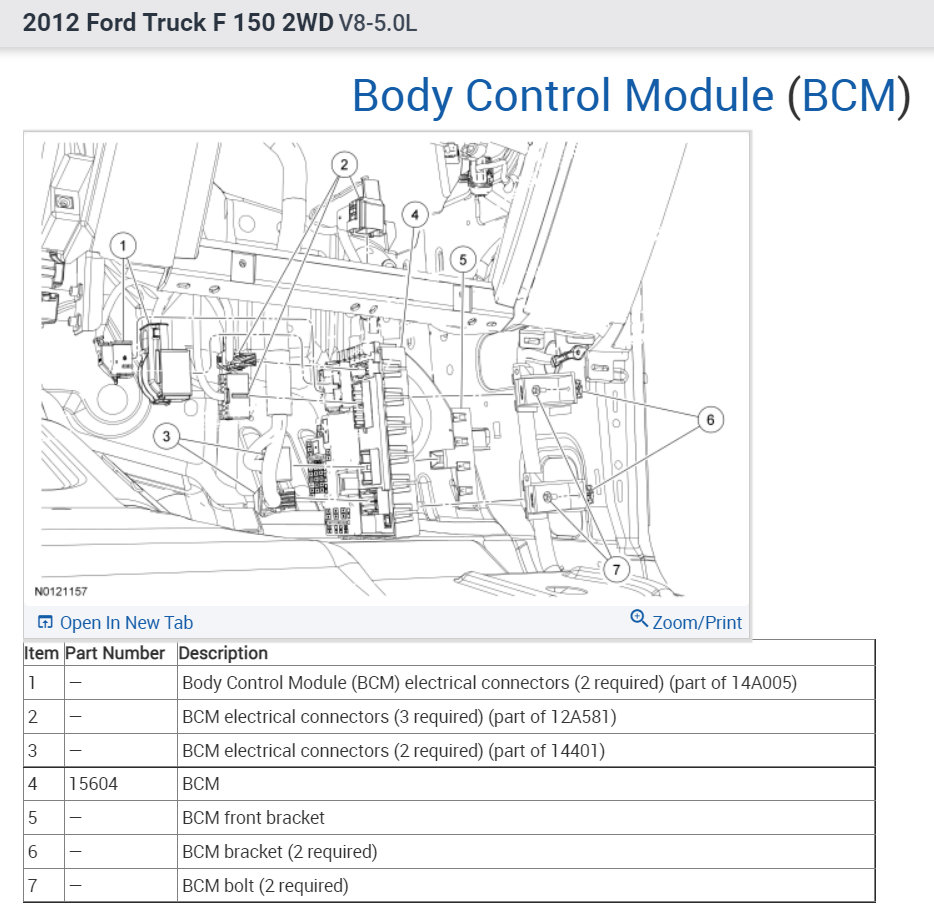

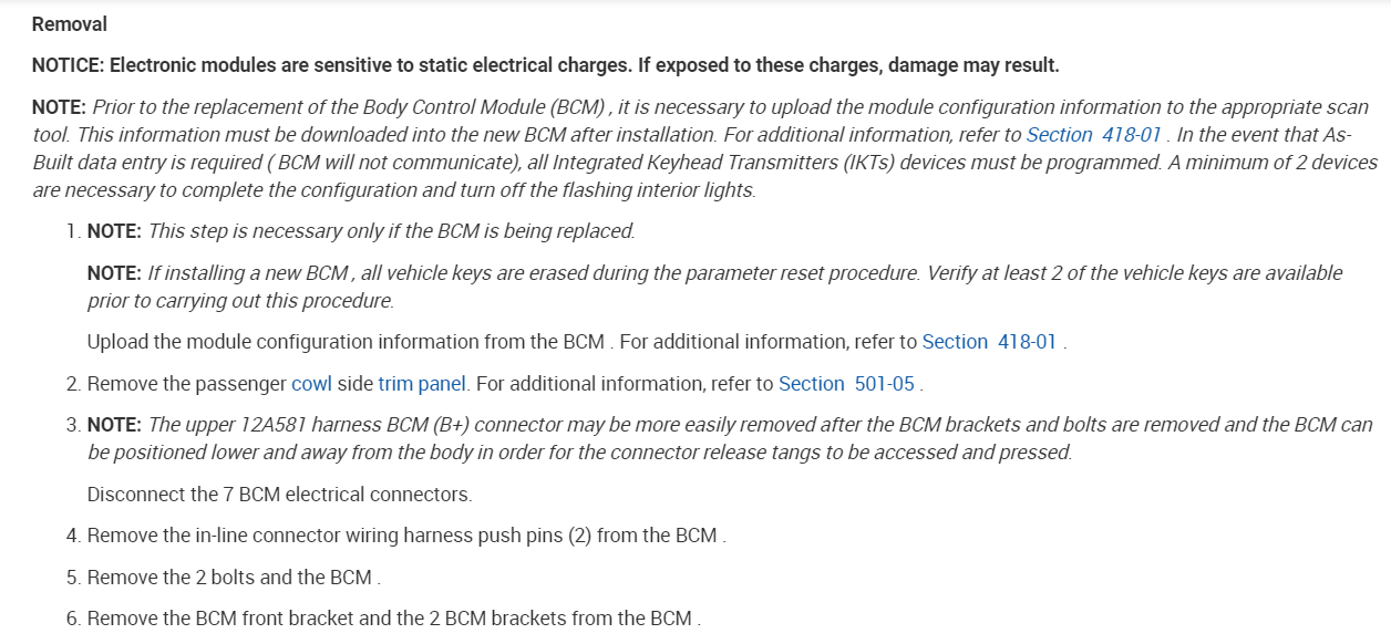

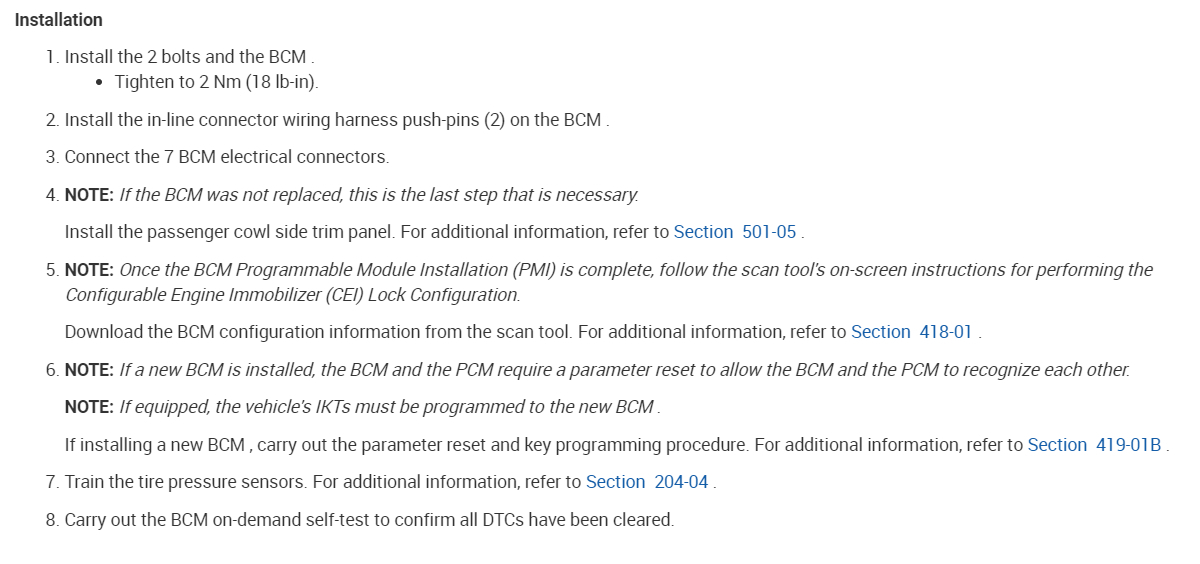

The speedometer and transmission depend on the speed input from the ABS and body control modules. To find out which one is bad let's do a CAN scan which is the future of automotive repair. You can get a CAN scanner from Amazon for about $30.00. here is a video to show you how and a link to a scanner from Amazon. I have included how to change out the BCM, which is what I think is bad.
https://youtu.be/u-4syLc-ifQ
and
https://amzn.to/3OpAotj for the scanner
